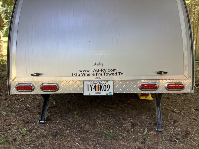

Shortly after buying a 2014 T@b 320 CSS I drove from Georgia to Oregon. Somewhere along the way I lost my license plate. After receiving a replacement plate, a friend made a bracket that allowed the plate and frame to be attached a bit higher so they didn’t hang below the bottom edge of the camper. He commented there was no license plate light, which I hadn’t noticed. There were 4 holes, each pair fairly close together vertically, where the old plate was attached. I’m assuming two of the holes were for a light. However, there are no wires visible. Can someone tell me how to access the wiring so I can install a new light?

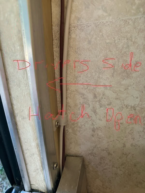

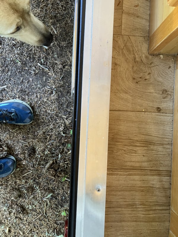

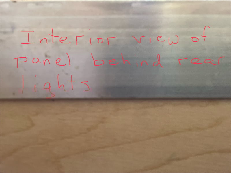

@Bayliss thank you for researching this. The 2014 Tab’s rear lights are on the diamond plate below the hatch cover. I did locate a white and a brown wire that run along the side wall that disappear under the metal cap that is screwed into the base of the hatch. I’m thinking that removing that cap may provide access to the wiring for the lights. See photos below.
@xslsand, it is possible those are your tail/running lamp wires (brown - positive; white - negative), but I have also seen nuCamp use green for those lights, so take that into consideration. They are green on my trailer, but it is a 2019 T@B 320 S Boondock Lite. If you look at the diagram of my electrical junction box (J-Box), which is located at the front exterior frame of the trailer (see post regarding the "J_Box") here: https://tab-rv.vanillacommunity.com/discussion/6406/electrical-resources#latest , you will see that the wire is green. BUT, brown has also been used for the tail/running lights in some RV electrical applications. If your J-Box is similarly configured, temporarily disconnecting the wire for the tail/running lights will tell you if that color wire is in fact controlling those lights.

If the metal cap depicted in your photos is easy to remove, that will likely resolve whether the brown wire you found is in fact connected to the taillights. If, for some reason, that does not expose the electrical connection, you could access the back side of one of the tail lights to determine what color wire is present. However, it might be more helpful (and more reassuring) to contact nuCamp directly and ask them how to access those wires for your model year trailer to add a license plate lamp, and ask if what you want to accomplish is doable. They would be in a better position to help you out with this issue.
