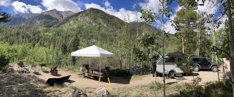

    A solar suitcase with a long cord to reach an unshaded area where you can chase the sun.
    We were at this primitive campground, Twin Peaks in Colorado for ten days. Batteries topped off before noon each day.

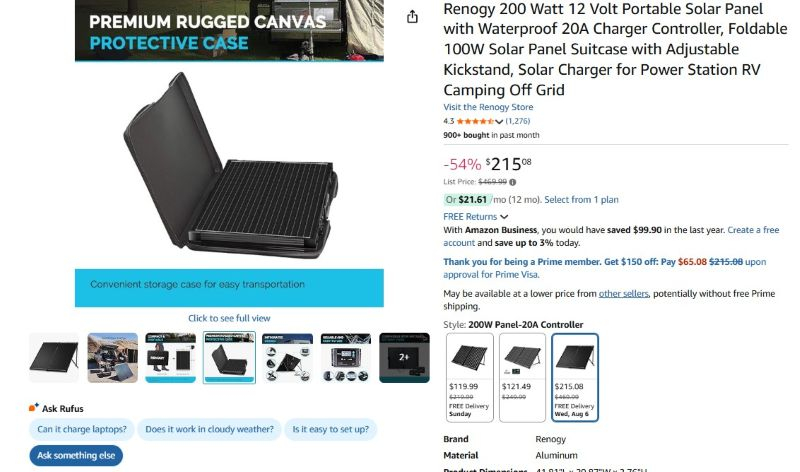

    I have a 2021 and use a 200 watt suitcase model, added a port, and a second solar controller.  It's not difficult but, depending upon when you're leaving it might be a stretch.
    A quicker option would to buy a suitcase panel with its own controller.  That way, you could just set it up and connect to your battery with the alligator clips that it comes with....super easy.  I'm guessing your battery is in the propane tub.  Depending on how far you are from sunlight, you may just need to buy and extension for the alligator cable.
    I bought this Renogy model and have been very happy with it.  It comes with a controller and alligator clips.  You can always add a port later if you like.  I bought a second Victron controller because I like the bluetooth function and...they say there are less losses if you mount the controller closer to the battery.
