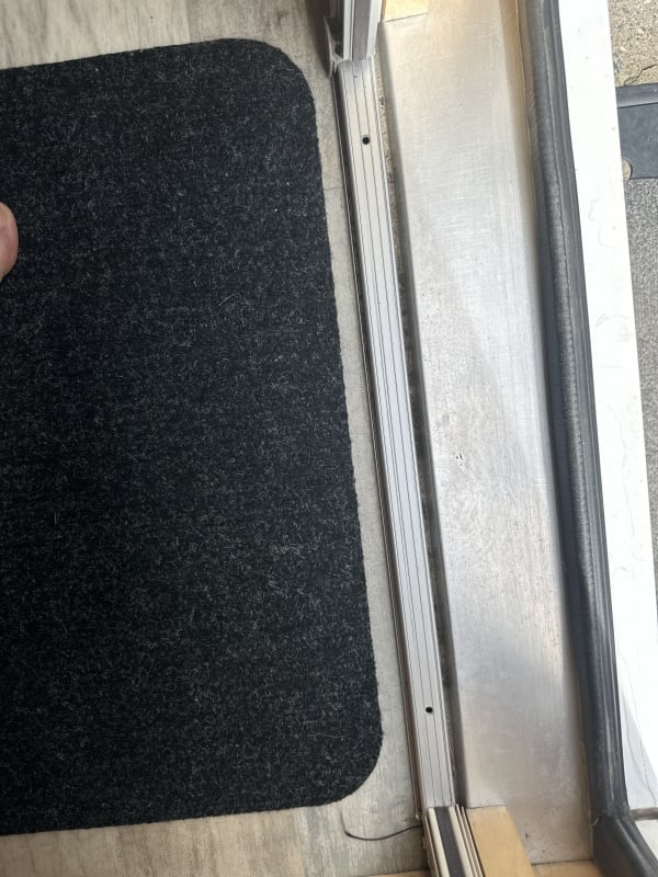

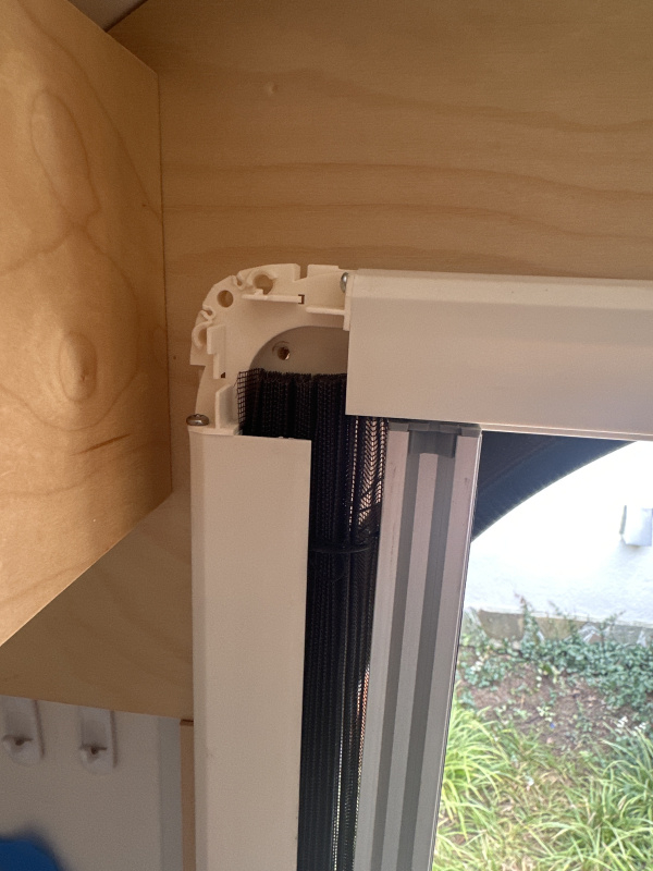

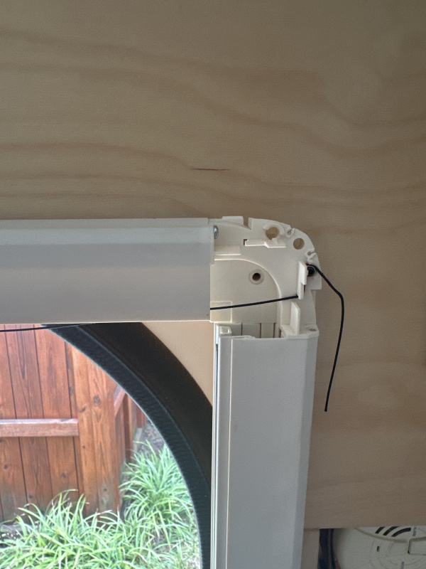

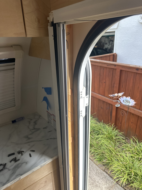

So here are some photos of our screen door. We don’t have felt at the threshold. Our TAB is a 2022 320 CSS. I feel like the door is fixed onto sides. I have not been able to lift the door off of a hanger system if that’s what is behind it. The door became jammed in place. And I pushed the upper edge hard enough to cause the cord to release the door but now it is in a loose condition.Can you offer advice. I would appreciate it.Malcolm0
And here are the photos
