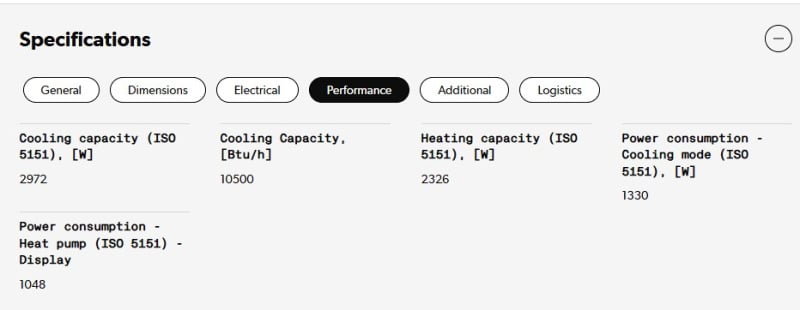

Does using the heat pump setting to cool draw less power than the regular ac? (My 2000w rated Wen generator starts and briefly runs the AC, but soon overloads it.

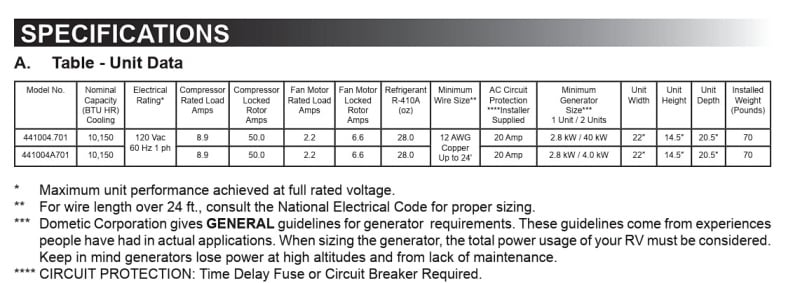

    As there is a single compressor and a reversing valve for cooling or heating, I suspect that the draw would be similar in either heating or cooling mode. But heating is less load than cooling per the Dometic site chart. I can say I have not run mine on a generator. Specs say the 2000W gen is too small. I guess the Soft Start helps with smaller generators.
