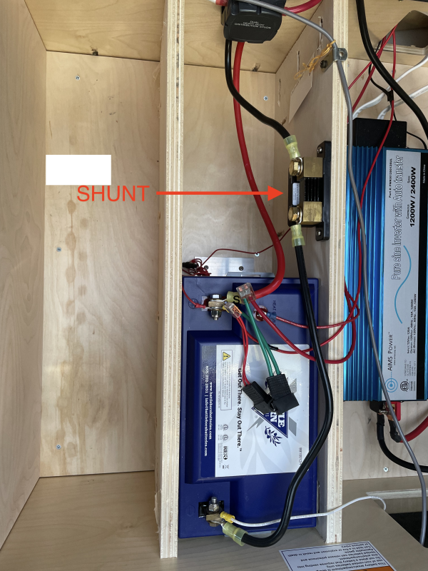

    @geoB, here is a photo of the Smart Shunt in our 2024 T@B 400. Note that it is located next to the battery and connected to the battery negative cable. In your photo of your battery compartment your negative cable runs to the left through the plywood bulkhead so if you indeed have a shunt installed you may find it in the compartment to the left, connected to the black negative cable coming through the plywood.

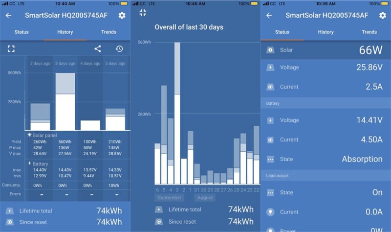

    If I might be permitted to throw a wrinkle in the discussion, one thing no one has proposed is the possibility that your rooftop solar panel is failing. I mention this only because your very first photos from Sept.3 show diminishing solar generation over the course of the previous 2-3 days, with some bulk generation but then no following absorption and float periods. I saw this same behavior in our system a year ago and flailed around on my own with the help of forum members trying to diagnose why the battery was progressively losing a charge and I was seeing only limited solar generation, mainly in the morning but none during the best sunlight hours. I finally took the camper to the dealer and it turned out that both our panels had failed and had to be replaced.

    Based on your SmartSolar shots today it looks like your solar panel is cranking nicely so please ignore what I offered. Battery testing per @MuttonChops recommendation may settle the question. If batteries have reached their end of life, consider moving to lithium(s) and also have a smart shunt added. By the way, I think that if you have a shunt it would show up in your Victron Connect app as what @MuttonChops referred to as "other Smart items".

    FYI.  Whatever that white wire is going to the negative terminal of the battery should be moved to the load side of the shunt.  Otherwise, it's not measuring the current and amp-hours through that white wire.

    As I recall from my setup, that white wire is from the Alde.

    @dsfdogs is correct, it is the negative wire to the DC power supply on the Alde secondary circuit board that there 3020 model has. It was wired this way from the factory I assume.
