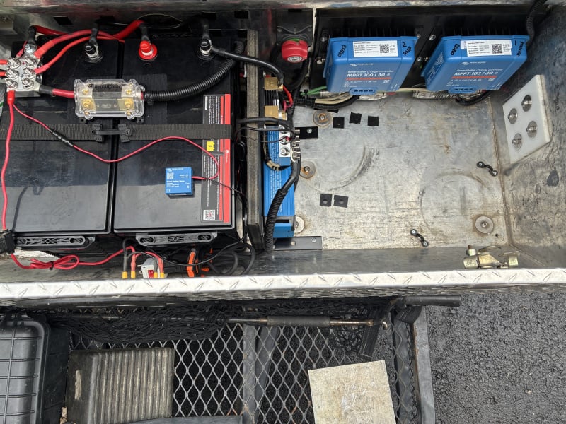

We store our T@B in a heated garage and don't camp in extreme cold, so the added indoor storage makes keeping our lithium batteries in the front outside storage box our preference. There are a few loose ends to finish up, but this upgrade to two 300Ah LiFePO4's is almost complete. I dragged it out of the garage between rain storms to do some testing. So far, so good.
Last winter I replaced the small factory rooftop solar panel with a 310W Sunflare panel that comes on 400 T@B's. I upgraded from the 75/10 Victron controller to a 100/30 to take advantage of the additional wattage. It worked considerably better, but the factory 10awg wire running from under the bench seat to the front box was resulting in too much voltage drop. My first thought was that I'd have to find a way to run heavier wire, but recently thought that I could simply move the controller closer to the battery. I'll need better sun for a good test, but the app voltage reading has me believing that it was a good move. Now I'm not seeing the different battery voltages from the two controllers.

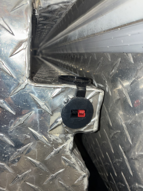

For good or bad, I reuse the post type distribution blocks from my old setup instead of dedicated bus bars. While at it I switched from the SAE solar suitcase port on the side of our box to a 45 Amp PP15 Anderson connection. ..... Yes, there will be a cover over the batteries.
Before installing, I fully charge each battery independently. I'm currently running the air conditioner to completely drain them. Looks like that will take about eight hours. Next up will be recharging to see if the shunt confirms the 600Ah capacity.
So, any comments or critiques on this amateur electric work?

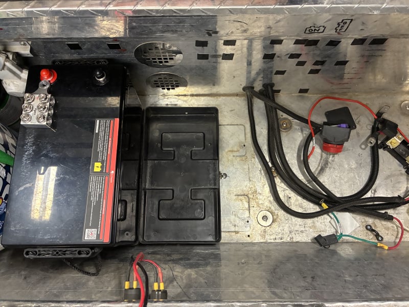

edit to mention that the battery boxes that the old 100Ah batteries were in were barely too small for the 300AH. At the base it was a good snug fit, but the taper and handles would keep the 300Ah from sliding all the way in. I ended up cutting the boxes about an inch up from the base and screwing that to the bottom of the truck box as a way to secure the battery from sliding. (see second picture)

    Well, I've seen worse .... :) Just kidding, looks good and clean. Moving the charge controllers close to the batteries avoids the potential issue with the controller having the wrong idea of the battery state of charge due to voltage drop. Also, the controllers being the MPPT type they can optimize voltage vs current even if the panel wiring is a bit longer.

    I think this install looks pretty good, but was wondering if the components are weather resistant. How much moisture gets in the tub when driving in a hard rain?

    @qhumberd, we've had the Tractor Supply box on for nearly five years and over 50K of towing miles. Even with the venting for propane, there has never been any significant moisture getting into the box. The lid seals very well.
    I'm not thinking that @Grumpy_G was being grumpy. There are certainly things about my mod that have room for improvement. I was hoping for constructive criticism and opinions on what might be seriously unsafe.
