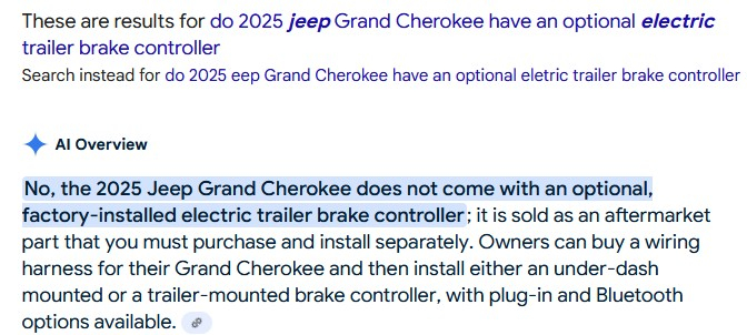

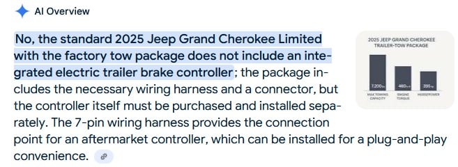

Two Google AI searches say 2025
Grand Cherokee does not have a factory installed Trailer Brake Controller or even offer one as a stand-alone or within package option (one search says it does).
However, Build A Jeep web page does not list or reference any TBC as a standard feature or option.However, double check your owners manual.
