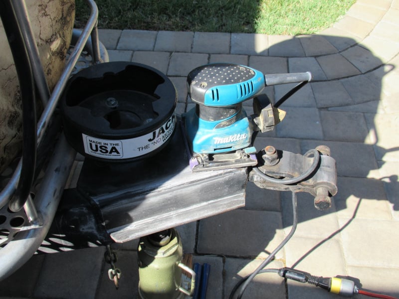

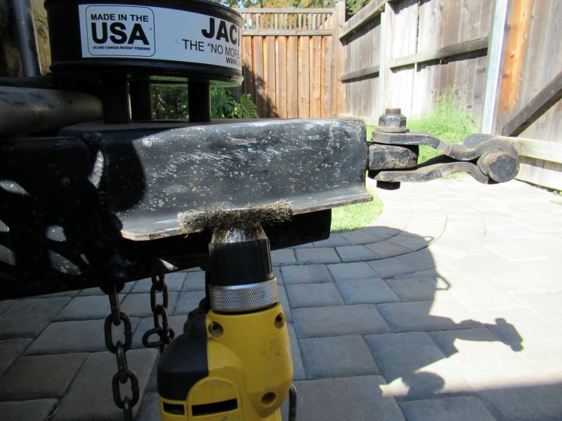

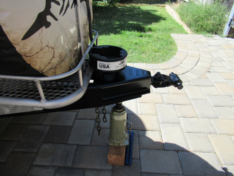

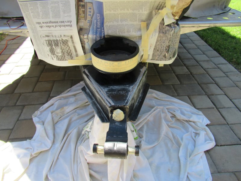

After six years our lock-n-roll coupler was starting to look it's age. (Note: a ball coupler can get pits and fade just as easily) We applied a wire brush, sand paper and cleaned with alcohol before masking. We used automotive engine paint to ensure good performance in the California sun. Like new again!

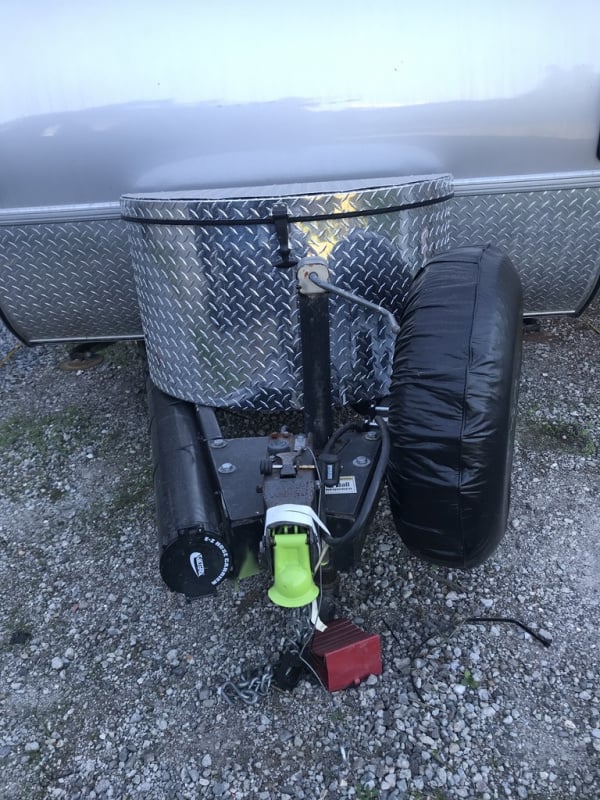

It's a bit unconventional, but I painted my coupler neon green to make it easier to see when hitching up.
5 -
Good idea! I lay a folded yellow hand towel over my coupler for the same purpose. Works well unless it’s windy.
