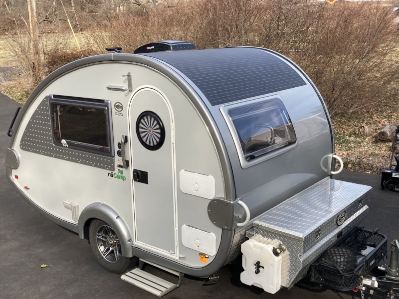

I installed the 180w SunFlare panel on the front of our 2018 CSS two months ago. (I'll post pictures once I take them.) The panel starts about 3 inches above the front window and goes within a few inches of the fan opening. The wires run through a hole I drilled into the bathroom vent cap, through the A/C space, behind the TV, down to the controller under the bench. I had already moved my batteries inside, sacrificing the lower front left cabinet. That probably was a mistake; I think they should be in the passenger bench, behind that side's Alde radiators.

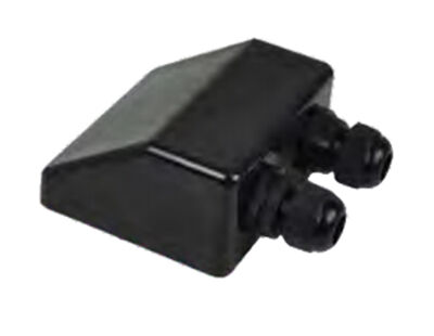

ckjs said:... The wires run through a hole I drilled into the bathroom vent cap solar cable entry gland I installed next to the vent cap, through the A/C space, behind the TV, ...
Oh dear, my memory: it's going.
I went out to take pictures and discovered that actually had I drilled a hole in the roof and installed something like this.
The panel looks like this:
2018 T@B 320 CS-S; Alde 3020; 4 cyl 2020 Subaru Outback Onyx XT1 -

ckjs said:ckjs said:... The wires run through a hole I drilled into the bathroom vent cap solar cable entry gland I installed next to the vent cap, through the A/C space, behind the TV, ...
This is the same panel i got for the rear of mine. Its different than the factory panel as they go in the roof under the panel I found out. And sun flare does not sell the panel to the public, its a 180w mono crystalline panel. That gland looks like the right part for the job for sure. It kind of sucks because of the different type of panels i have to use 2 mppt controllers.0 -
Although I had problems trying to buy from Sunflare, I was able to purchase their 310W panel through nuCamp. I went through my dealer (Miller in PA) and had it drop shipped to my house. Having the connections under the panel is a cleaner installation.Sledhead1 said:
... Its different than the factory panel as they go in the roof under the panel I found out. And sun flare does not sell the panel to the public,
Huge improvement over the 100W factory installed panel ...
I didnt even know they had a 310w panel. Thats awesome.0

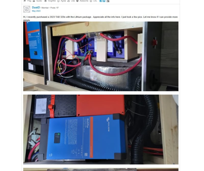

I believe the factory fit for the Lithium upgrade on the CS-S has one battery turned 90 degrees and located forward of the passenger wheel well, the second battery located more or less where it is in the single battery configuration, but, shifted aft to accommodate the first battery and the multiplus wedged in between the Air8 and the second battery. It's a tight fit.Sledhead1 said:Yoshi_TAB said:Hi
I found these in another post on this forum.
That better than i found. The battery wiring is very helpful, but the mutiplus cant go there in a css, its shorter inside and my ac is right by the batteries. The only possible, and im not sure it is, is behind the wfco. Every other spot is full.
2024 320 CS-S | Ontario, Canada0 -
Oh, i would like to see pictures of that. im guessing its on its side then ?0
This is the thread that Yanni in an earlier comment brought some photos from. Lots of good information in the rest of the thread:When NuCamp brings out a "new version" or design in a trailer, there can be many running changes in trailers that were built only a few days or weeks apart. And, probably even more if the trailers are a year apart. So, some of the work you might want to do will have to be "creative" on your part to make things fit, etc.Lots of owners have done various mods like you want to do, there will be plenty of help.
Sledhead1 said:Oh, i would like to see pictures of that. im guessing its on its side then ?
Yes, I believe the Multiplus was mounted on it's side. Unfortunately I can't locate the picture I saw. I was thinking of the same mod, but, it looked like such a tight fit I'm not sure it's worth the effort. I may just go with just an inverter to save space. It's unfortunate that Victron doesn't make a 2000W standalone inverter. On the other hand, it might be worth looking at a single larger capacity battery that would fit crossways in front of the wheel well. That would leave more room for the Multiplus. Battleborn, Renogy, and I think LiTime all make larger capactiy batteries in various form factors that might work. The next time I'm at my trailer I'll take some measurements.2024 320 CS-S | Ontario, Canada1 -
