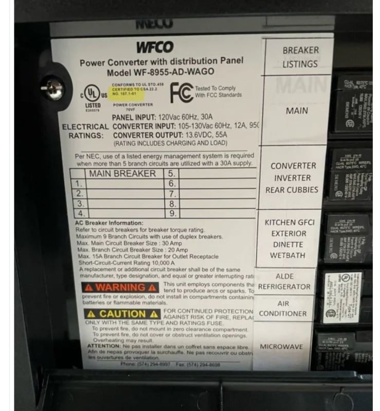

    A lithium battery can be a straight replacement.  We would have to check the version of your WFCO converter.  Earlier "non-lithium" converters could charge a lithium, but "only" to about 85 percent.  Newer versions from around your model year might have had a WFCO with a "switch" that told the charger to use lithium charging profiles.  Later WFCO's had "auto detect" chargers that were supposed to detect lithium batteries.
    So, have a look inside your WFCO and check the model number.  It will be something like "8735" and a designation of LiS for the switch model, or AD for the auto detect.  (A 2021 "might" have the LiS version).

    pthomas745 Administrator, Moderator Posts: 4,673
    Here is a picture of the label inside your converter. This one has the "AD" designation, which is the "auto detect" model.  The other version is the LiS, or lithium switch model.  Your 2021 may not have either designation, which would mean it is a "non-lithium" sort of converter. The "non-lithium" would still charge the lithium battery, but only about 85 percent.

    jdzioba Member Posts: 21
    I also have a 21 400 Boondock. Planning on upgrading to Lithium next year. Where is this converter located?

    qhumberd Administrator, Moderator Posts: 888
    @jdzioba your panel is always near the floor but can be near bed, or dinette area. The panel opens by a push to reveal the breakers and fuses.
    In our 2019 it is under the closet, as we have the small fridge.
