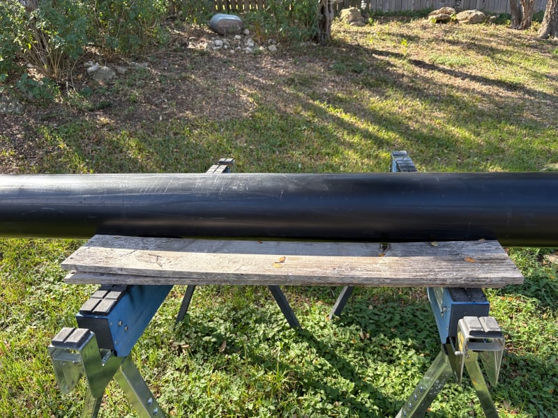

I got a 5' long 6" diameter ABS (because it wanted it to be black) pipe from these guys: https://www.plumbersstock.com/pia6.html

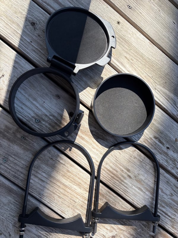

I hunted around trying to find end caps and stumbled across what is called a conduit carrier kit from Amazon: https://www.amazon.com/dp/B0CHM2G2B3?th=1
Then I got a can of black satin spray paint and some black 8" radiator clamps (aka jubilee clips, aka worm gear clamps).

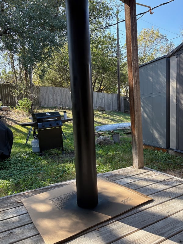

I sanded the pipe and painted it (having it already be black made the job a lot easier) and then glued on the end caps.

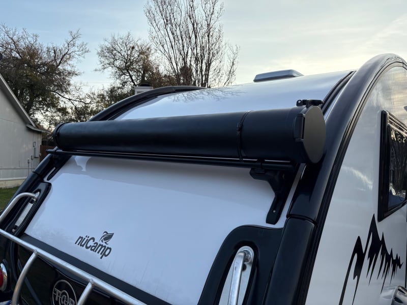

Then I adjusted the cross bars on the Yakima rack so I could nestle the tube in them and attached the radiator clips alternating between encompassing the tube and the top bar and the tube and the bottom bar.

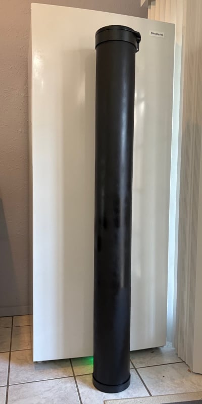

It's not as professional looking as I had pictured it in my mind, but it's not too shabby... and, did I mention the elbow fits inside? I also added a 5' section of water hose since on my last trip to the dump station there was no hose, only a spigot which made rinsing things out a challenge. Fortunately I had a section of like a 2' hose (you know, the kind with plastic female attachments on both ends) that I made do with.

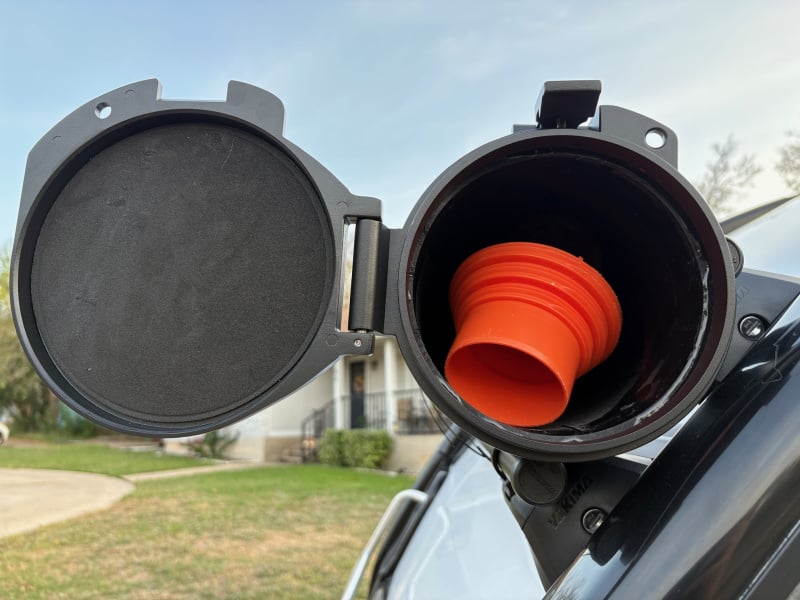

…and I just realized the part that opens is on the wrong side of the camper!! Crap! I even had it correct and reversed it at the last minute. WTF!? Sigh, well I ain’t redoing it now. Maybe.2025 Tab 320 S BD2024 Nissan Frontier0
Looks pretty professional to me! My hose fits in a standard carrier with the elbow, but I have to disconnect the cone thingy that sticks in the skank water hole. Not having to do that would be a real plus.2015 T@B Max S (320)
