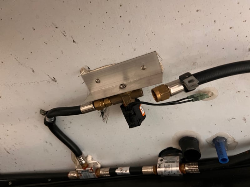

I am re modeling the rear kitchen on out 22 Tab 320 CS-S and removing the rear stove and noticed there is a valve with 2 electrical wires and a T fitting under the rear of the Kitchen area, What is the electrical valve for?
It is connected to a switch on one of the struts for the rear hatch. It turns off the gas flow to the stove when the hatch is closedUltimate Toys Teardrop Camper
Volvo XC-40
SF Bay Area, California -
Awesome thanks. That's why it was warm as the hatch was open all day!
A common modification is to add an additional switch in series in that circuit to turn the gas valve off when the stove is not being used.
The solenoid valve draws ~1 amp constantly while the hatch is open. When camping off grid, this is a significant draw especially if you keep the hatch open as part of living space.
Good point, Being as I have removed the stove I think I will just un plug it.
