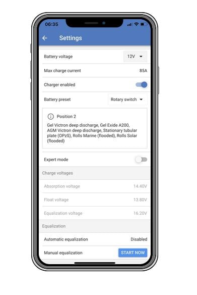

    @Horigan if you remove the fuse by the victron would that shut off the power coming in from solar?
    2021 T@B 400 Boondock; TV: 2019 F150 3.5 EB
    The easiest way to stop solar from getting to the battery is with the "Charging Enabled" toggle" on the battery settings page. Just toggle the charger off.
    Once you start pulling battery fuses, there can be complications with the Victron devices.  There is a very specific "start up"procedure for the solar controller: the battery needs to be connected to the controller first, so the controller can read the battery voltage correctly.
    Yes.  Per @pthomas745 above, always have the battery side powered before reconnecting the solar side.
