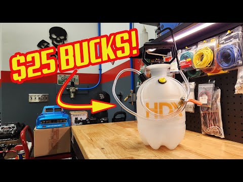

    Recently, through some miracle of the web, I found a "Winterizing" thread from waaaay back in 2015 from "Pop-Tab".  They developed a very simple garden sprayer pump to drive AF into the plumbing lines "without" having to fill the fresh water tank with AF and then use the pump to bring the AF to the faucets.
    This thread has the instructions on how to build this simple setup.  I'm certain that this process will work through the city water connection even with the simplest of manual or electric pumps.
    I built the same version of "Pop-Tab's" pump, but, of course, would up on YouTube and found people who have modified these spray pump bottles to do many things, such as basic fluid transfers.  One video showed me how to completely reconfigure my pump bottle with 1/4 inch inner diameter tubing and 1/4 inch valves, etc.  The "original" version of Pop Tab's pump worked fine, but the "reconfigured" version turned out to be more efficient and powerful. This is the video that shows how to do this.  (PS:  I made my version with the HDX 1 gallon sprayer from "local big box store" and the ergonomics and finishes are just terrible.  How can you make a pump sprayer with the pump handle with such sharp edges that it will cut your palm?)  I'm going to find a Chapin 1 gallon sprayer and use that one intead.
