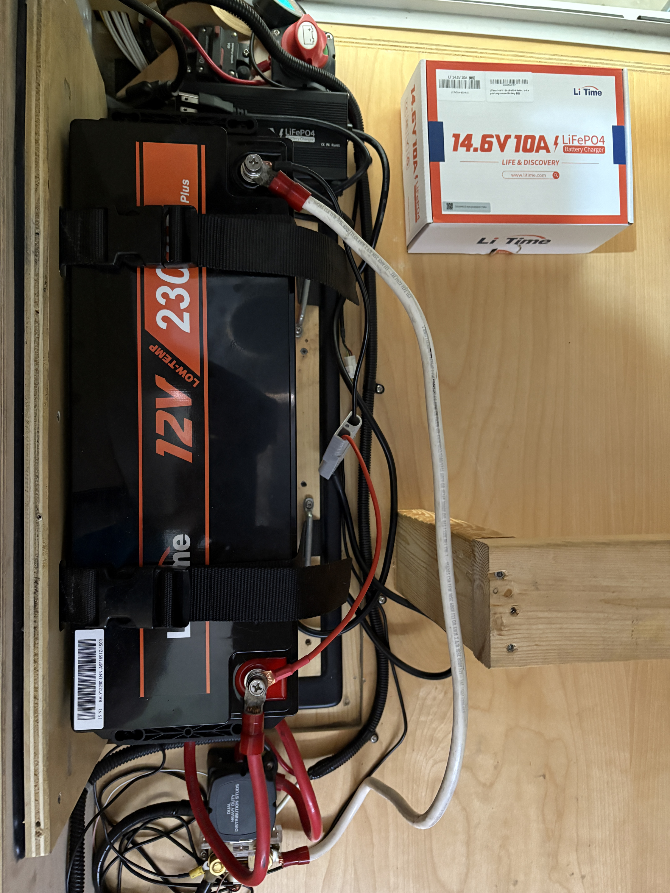

    In the meantime you just have to decide which battery you trust and can understand. I replaced my 2 6V lead acid Harris batteries with a single LiTime 230 amp hour lithium and it is working fine. I am sure others with a better electrical background can help as well.
