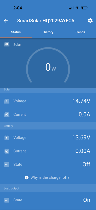

I’m solar illiterate so please bear with me. I just picked up a 2021 t@b 320. I found the PUK and reset the pin hurdle #1 passed. My problem is the app says that the charger is off. I clicked why is the charger off and it says “insufficient PV power” I checked the wire connections and everything is tight. Next I checked fuses and all fuses were good. Any tips on where to start
At 13.69V, your battery is probably fully charged. Also the solar voltage has to be five volts more than the battery voltage to start charging..

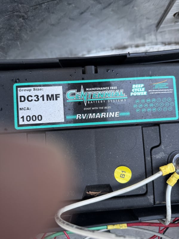

Welcome to the Forums! Good for you for getting past the PUK number quest.Tell us what battery setup you have. The "battery voltage" number "looks" pretty good, but this depends a bit on what exact battery you have, and whether or not you are plugged into shore power.So, in other words, this is all pretty normal for a charged battery. Tell us what the battery type is. Then, lets take a look at the "settings" for the solar charging.
Welcome! We also have a 2021 320. There is a lot to learn. This forum will help.A big thing, as @AnOldUR said, is that the Victron solar controller requires the solar panel output to be >5 volts higher than your battery voltage to start charging. There’s a video from Victron explaining why they made that choice. So things look reasonable from your display. The battery voltage will have to get lower or your solar output will have to get higher for any charging to happen.2021 320S BD

The battery is an AGM deep cycle RV/Marine battery. It was not plugged into shore power when I took that pic.pthomas745 said:Welcome to the Forums! Good for you for getting past the PUK number quest.Tell us what battery setup you have. The "battery voltage" number "looks" pretty good, but this depends a bit on what exact battery you have, and whether or not you are plugged into shore power.So, in other words, this is all pretty normal for a charged battery. Tell us what the battery type is. Then, let’s take a look at the "settings" for the solar charging.0 -

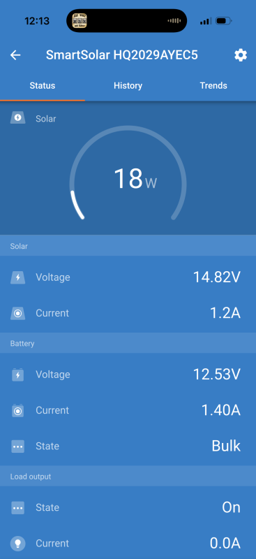

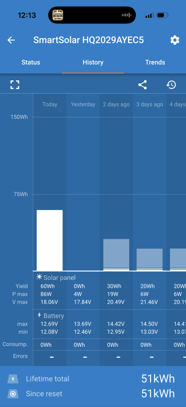

I turned several 12v things on this am to use battery power. It kicked the solar charger on, thanks for the help!! Here’s a screen shot of it & a pic of what battery is in the trailer.
Smitty55 said:...It kicked the solar charger on, thanks for the help!! Here’s a screen shot of it & a pic of what battery is in the trailer.
If the panel were in the sun at that time, and properly oriented to it, it should have been providing more than 14.82 volts.
Typical panels generate at ~20v in good situations. Less than 18v might be due to shade - even "high shade" - a partially defective panel, or high-resistance wiring. If the panel is perpendicular to the sun, it should provide its rated voltage, even when the battery is full and there's no current draw.Charles & Judy, Santa Cruz, CA
