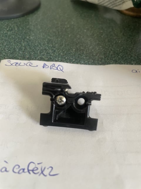

Hi there- I've got a broken plastic friction piece for the shade on the stargazer window. Does anyone have a bush fix/repair recommend.
Photo, attached. Thanks
Mark
Mark
I did a bush fix (nice term). I cut a corner off a plastic wall outlet cover plate. I drilled a tiny hole and screwed it to the window glide. Then I built it up to sort of match the other side using Scotch tape as a frame mold for JB Weld epoxy putty. I made grooves for the cords to keep them in place and to reduce friction. A bush fix. Amazingly, it worked!0
