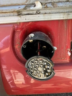

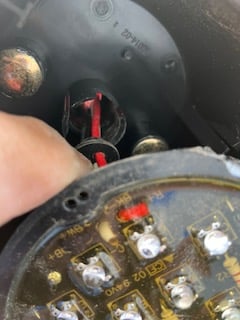

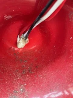

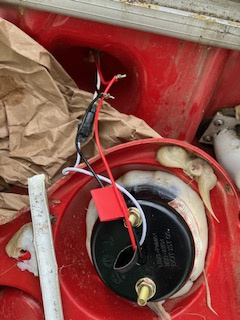

This is a new post following my 7-pin plug issue. I think I traced it to a rear taillight. My new problem is that the taillight does not just pop out. I took off the small plastic housing, pulled the taillight out, pulled the junction box out, and it looks like the wiring goes further into the housing. I have attached (4) pictures that show, hopefully, my dilemma. Two questions: 1) do I have to take off the whole back-end plastic or am cutting and splicing? 2) where can I get a replacement for the rear light?
There have been several threads about LED replacement tail lights in the past. Try this to start, which has a part number for the "Kaper" II.This thread has the same link embedded in a comment, but there are also pictures of the install.And, here is another I just stumbled across.There may be some differences in various years, of course, compared to your 2016. But the part and process should be close to the same.

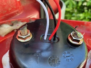

They worked when I test wired one of them. Three things that I learned: 1) there are two bolts with washers that keep the junction box together. I needed to cut down both bolts because they were too long to fit into the taillight housing (attached photo). 2) I needed to cut the wiring from the old taillight to wire the new taillight. No plug-ins… I soldered, heat wrapped and taped the (3) sets of wires together; and 3) I needed to use a silicone adhesive to keep the junction box snug/attached to the taillight housing (attached photo). Without this, the taillight junction box will move around.
