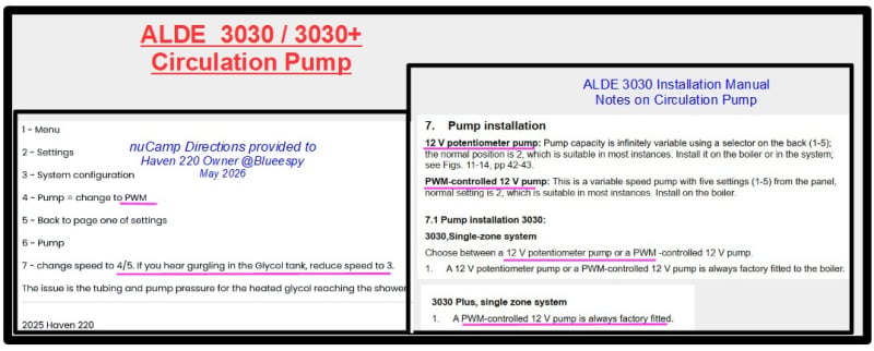

The ALDE 3030 Manuals I've located (so far) have zero information on the 'System Configuration' page features/options/setting. So @Blueespy post is our first look behind the curtain 😉
This Chart combines the nüCamp instructions and ALDE information on the circulation pump types.
