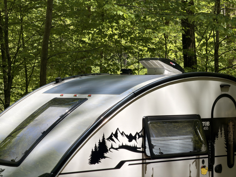

I’m sitting in partial shade (see photo) my charger says it’s off, generating 0W. Is this expected behavior? I would have thought (having solar on my roof at home) that even sitting in full shade I’d see a little generation. 2024 BD, 310W solar on roof.
I’ve seen some posts on the forum about a known issue with failing panels on this model year, but everything I’ve read seems to suggest that once the panel fails, it’s done and cooked. Thing is, looking back in the history my panel does generate power sometimes

    Generally that amount of shade affects the solar panel output significantly. For verification that it's not the panel that is the problem just check the charge controller when the panel is in full sun.

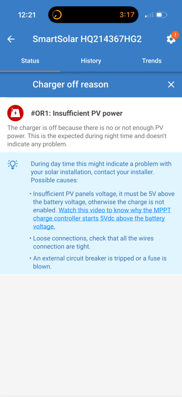

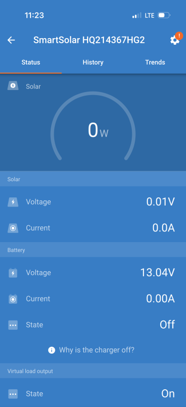

    The voltage from the solar panels must be at least 5V higher than the voltage of the battery for the solar controller to start sending power to the battery. Your battery is at 13.05v so the panels will need to show 18.05v for the controller to start charging.
    However, according to your screenshot, the voltage from your panel is only 0.01v, which seems very low indeed, even under the trees. I was camping under giant redwoods a couple of weeks ago with a 200w panel and the output was measly, but they did produce some power.
    I think that you'll need to get the trailer into full sunlight to confirm whether the panels are actually dead/defective. You might also want to check the connection between the panels and the controller.

    Yeah, the previous evening in similar lighting conditions I was seeing ~17-18v, and a couple watts of generation. Will check in full sun sometime, crossing my fingers it’s just a loose connection!
