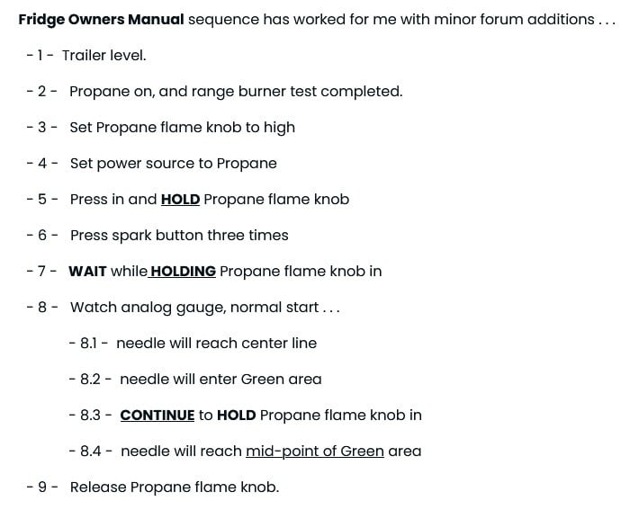

Here is the recommended sequence fro starting the n180 3-way Fridge on Propane.

@ktsame, I no longer have the N180 refrigerator (I upgraded to an Isotherm), but I have attached my notes that I put together, or collected from the Forum. Maybe you will find some helpful info in them.
