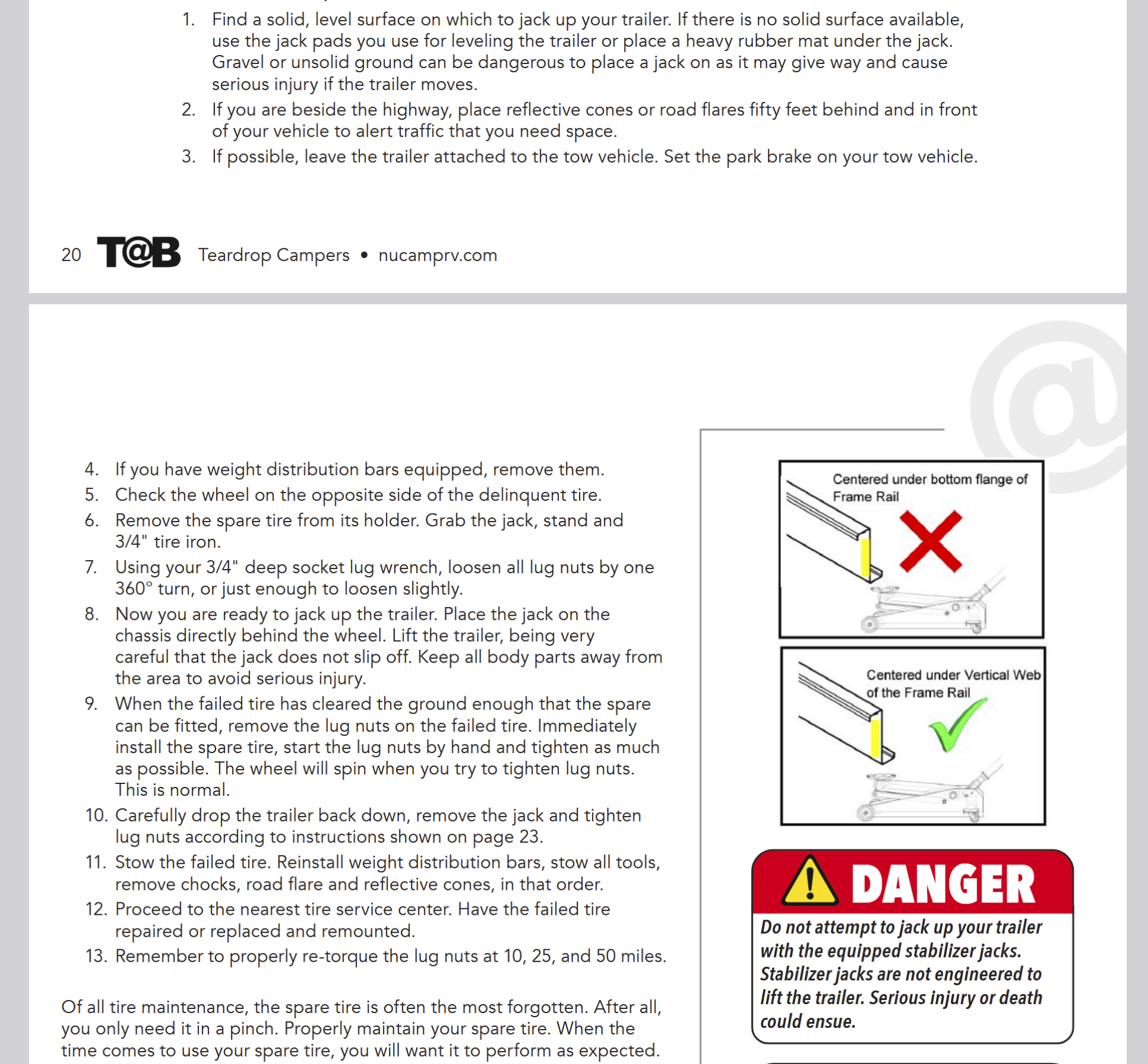

I had a quick look at both the 320 and the 360 manuals, and the show something just a bit different as far as where to place the jack on the frame, and of course, it isn't very clear.
This is the page from the 320 manual. The 360 manual has the same page. What they are trying to say (I think!) is to make sure you have the jack located "across" the frame rail, and not on the "lip" of the frame rail. The thread below has some photos of what the "frame behind the wheel" looks. If you could get down there and take a photo to see if your newer 360 matches what the earlier trailers look like, that would be very nice.

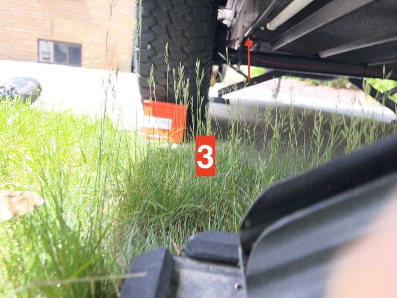

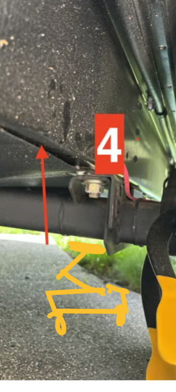

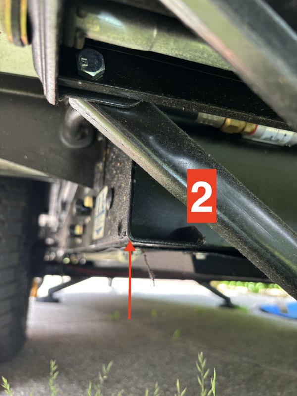

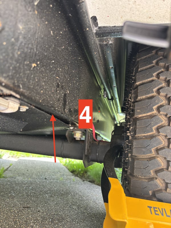

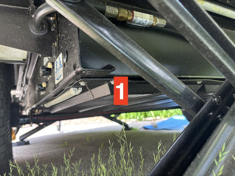

Photo 1 shows the frame rail. Note also the under-glow lights, which limit where a jack could be placed. Photo 2 show where I believe the jack should be centered. Photo 3 shows where I would think the jack should be placed (close to the axle as in the photo or just in front of the axle in Photo 4.)
They don't make this easy! In the description of the tire change, the manual says "Place the jack on the chassis directly behind the wheel." And then, they have that odd diagram that tries to explain "something". When I look at the photos of the 400's from the other linked thread, there is a nice flat wide spot behind the wheel on the actual trailer frame where the jack would seem to fit just fine.
In your pictures of the frame rails, you can see there is a lot of space where a jack or a jack stand would fit squarely on the rail itself. Your photos (1 and 2) show that rail is fairly wide. On my 2017 320, the frame rail in the same basic spot is only about 1 inch wide.
I know one should not jack at the center of the axle, but why not set the jack at the square axle box, below where the frame is bolted on, as shown in yellow? Sturdy, solid and flat, and lower. I've used this location for bearing inspection lifts.
