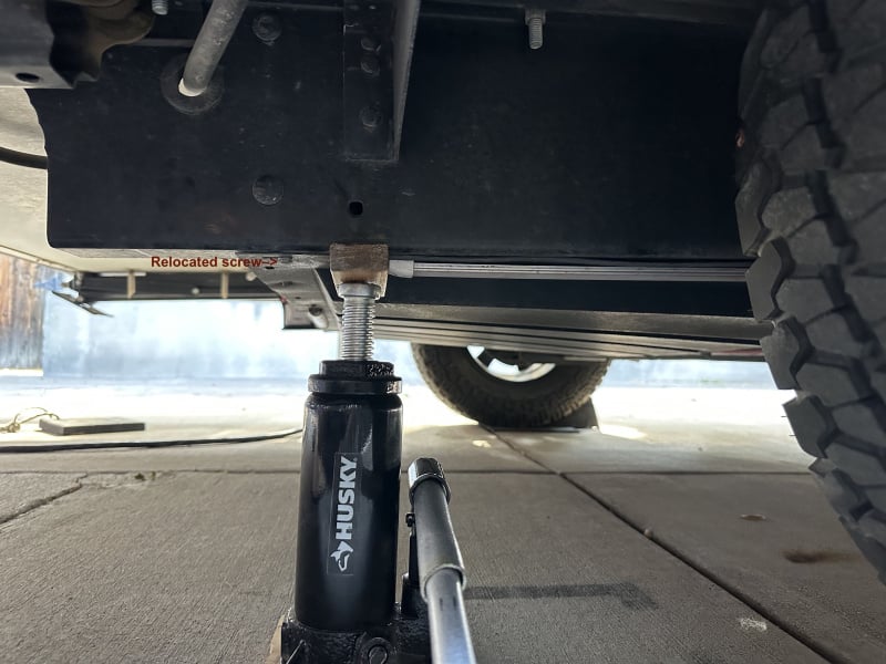

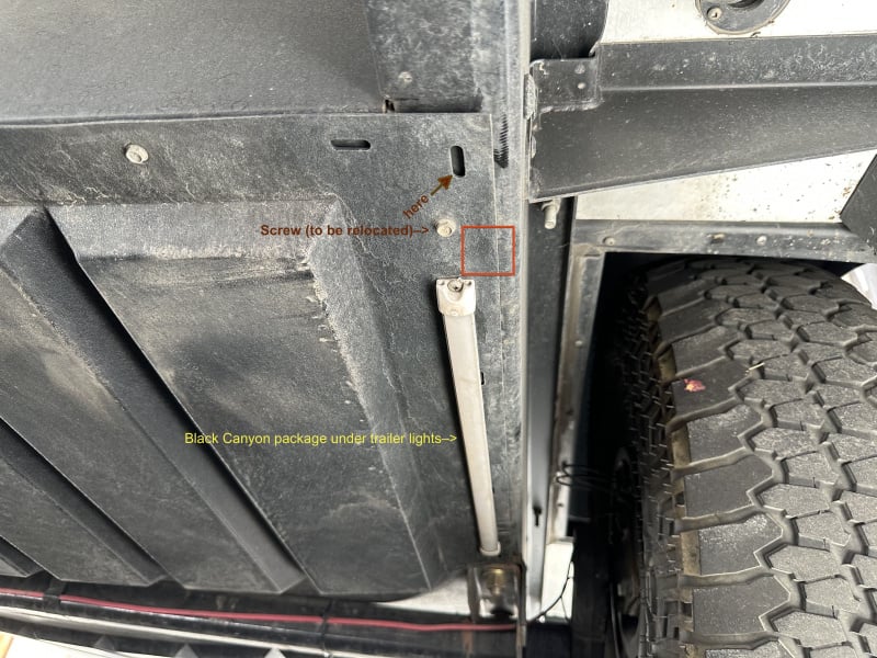

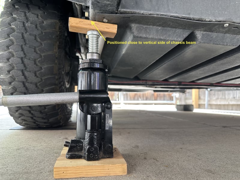

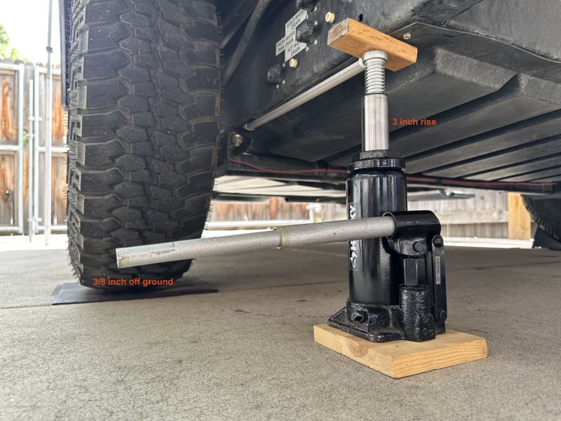

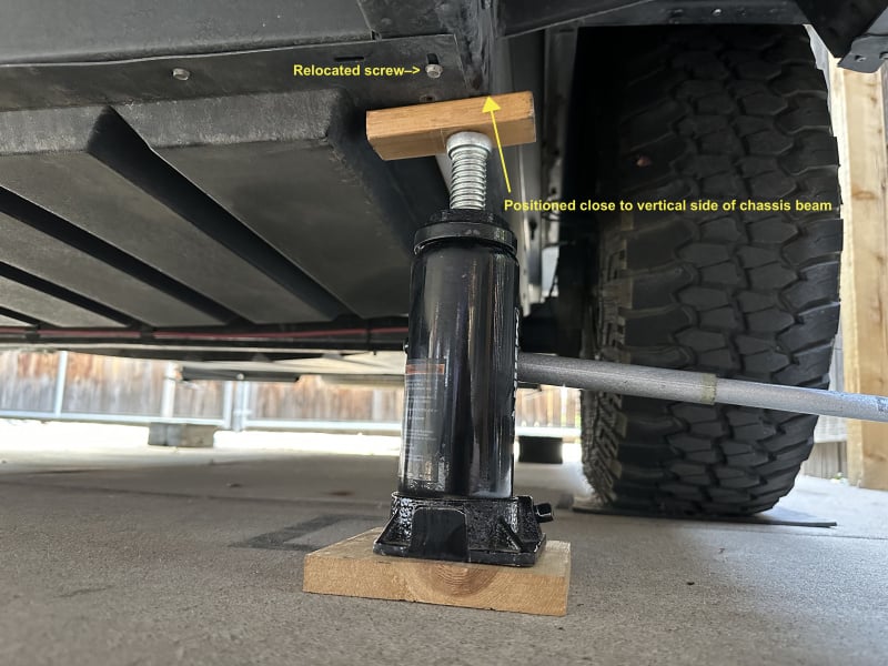

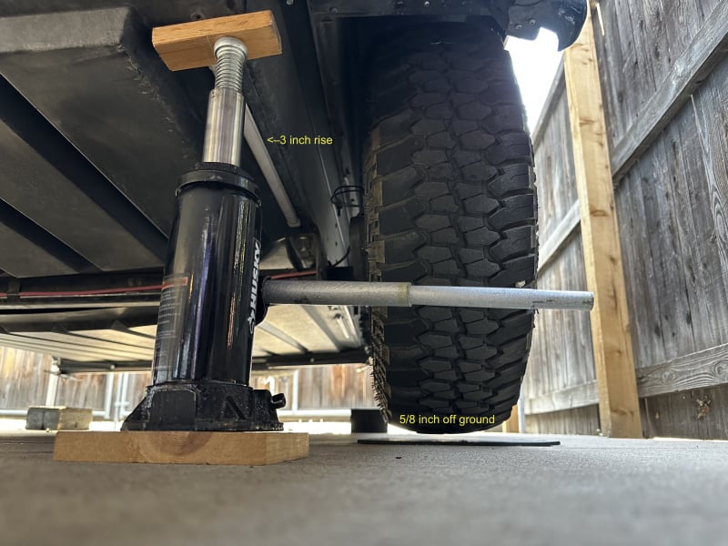

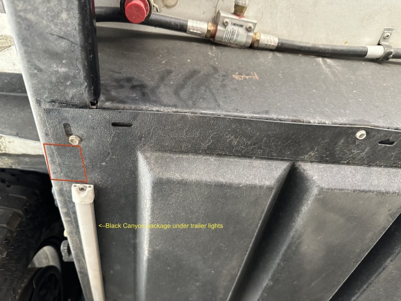

    @pthomas745 @EasternJL Pics (below) show where I elected to position the jack on my 2024 TAB 400 Black Canyon. It is easily accessible and safe to jack up (i.e., body parts are NOT under the trailer to facilitate jacking). nüCamp restricted the location of the jack points by placing the Black Canyon package under-trailer lights right where a jack could be positioned and sorta randomly placed screws to hold the plastic undercover, one of which I relocated. I encountered absolutely no indication of a problem with these locations (e.g., bowing, bending, groaning) when it was jacked up.
    2024 TAB400 BC Jack Point 1 Left.jpg 2024 TAB400 BC Jack Point 2 Left side jack position.jpg 2024 TAB400 BC Jack Point 3 Left side wheel jacked-3 inch rise.jpg 2024 TAB400 BC Jack Point 4 Right.jpg 2024 TAB400 BC Jack Point 5 Right side jack position.jpg 2024 TAB400 BC Jack Point 6 Right side jack position.jpg 2024 TAB400 BC Jack Point 7 Right side wheel jacked-3 inch rise.jpg
    2024 TAB 400 BC 2024 Subaru Ascent Premium Denver, CO Rocky Mtns & CO Plateau
