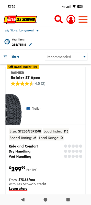

    Interesting. I'm having the original LT flavor tires on my '21 TAB 400 replaced on Monday with the 235/75/15 Rainier Apex ST at a Les Schwab store in Colorado. I just double checked to make sure they do have those specific tires.
  • JDRotz
    JDRotz Member Posts: 15
    Pretty pricey, but I tow on a lot of rough dirt roads.

    JDRotz, that's amazing, you found a set! 😀 …. I'm gonna check all the Les Schwab's in the country! Thanks for the heads up. I'll happily $600 for a pair just to be done with this search for the right tire for my Tab400 Boondock.

    RemoLyn, gotta say that I'm rethinking the Rainier tires. Made in China, and overall reviews are just ok. I'm going to go check out the Goodyear Endurance at Discount before having Schwab install the Rainier's. (They're $100 cheaper, too.)
    I like the idea of thicker, heavier tread for rough gravel roads, but I don't do any serious dispersed site boondocking, and most of the miles are highway.
    .Checked the DOT date, and my current factory LT tires are 7 years old, so it's time.
