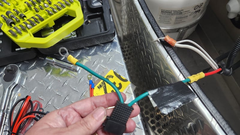

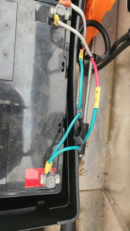

2022 T@B 320 CS-S. I am working on moving my battery inside the camper. I am abandoning the wiring to the tongue and splicing in new wiring from the converter to the battery and a new cutoff switch. My question is: what is this 3rd negative going to the original battery for? Two positive wires are going to the battery. One is from the cutoff switch, and the other is coming from the solar controller. There are three negatives. I know one is coming from the solar controller, and 2 negatives are coming from the battery cutoff. What is that third negative for? (See photos) The first picture is the original battery hookup. The 2nd picture is showing the positive from the cutoff switch and the 2 negative wires from the cutoff switch.

@Mouseketab, do you by chance have a photo of the wire connections inside the battery disconnect switch as it was originally wired, that you can post? Also, do you have a battery monitor that uses a shunt? If so, do you have a picture of those wire connections? (NOTE: In your first photo, I can only clearly see two negative wires connected to the negative terminal of the battery - - one with a yellow ring terminal connector, and the other with a red ring terminal connector).
I am unclear as to why there would be any negative wires connected to the disconnect switch.
Usually, it is just the positive ("+") wire connected through the switch (to cut/disconnect the 12V power running though that wire), BUT it could alternatively be connected to the negative wire instead. Regardless, I have never seen a positive AND negative wire connected to a 12V disconnect switch. I also only see two white ("-") wires in the second photo, which I assume are the same two depicted in the first photo, although one of those wires in the second photo appear to be a different gauge wire than the other, so I am unclear about that as well.

OK, it's not connected directly to the disconnect switch, but it is running through that set of wires (It's all bundled in a wire chase) So, that is the set of wires coming through from the converter, and the other set of wires with only the single negative is coming from the solar controller. No, I do not have an inverter.

Yes, the top photo is not clear. There are three negative wires when everything was connected. The third negative is just hidden a bit. The 2nd photo shows the two negatives connected together with the wire bundle. I did not picture the 2nd set of wires (1 positive, 1 negative) in the 2nd photo. I have figured this out. Many folks have told me that third negative was coming directly from the Alde.
