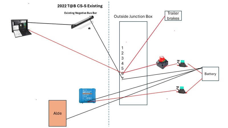

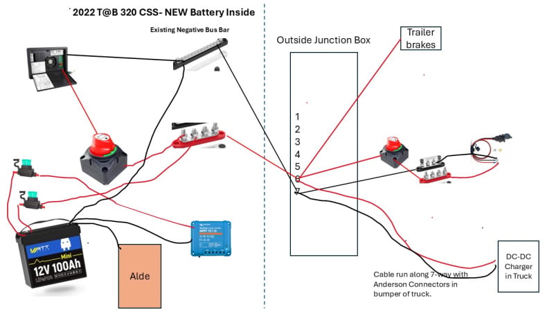

2022 T@B 320 CS-S. OK, after I've spent hours reading threads, and looking at pictures and asking questions. I think I've got it correct for my new wiring and moving my battery inside. (I took an idea from someone else's drawings, and made my own adding the negative wiring, and adding the solar controller). Please put your opinions if I've got this correct please. Thanks! (I used Red for positive and black for negative)
After asking questions, I'm pretty sure this is my original setup. (Thanks to the forum member(s) for your previous drawings. I copied heavily).
This is what I believe I should do for the new. Straight lines are existing or relocated. Curvy lines are new. The new item in the tub is a 12V power port that I'm going to mount through the wall of one of the bins. I am going to disconnect/cut the original wiring from the solar controller out to the tub.
The DC-DC charger is already in my truck. I installed that years ago for my former T@B, but I've not run the wiring to the new T@B yet. (I pulled it out of the old T@B, but just need to install the correct connection rings, and run it along the 7-way and into the box below the T@B).
Also, yes a 100AH lithium will suit my needs. Mainly need battery power for my fridge while driving, and powering my 12V freezer when parked. (Work parking lot before trips, going straight back to work after trips, and touring spot parking lots after checkout, but before starting my drive home). I use full hookup campgrounds.

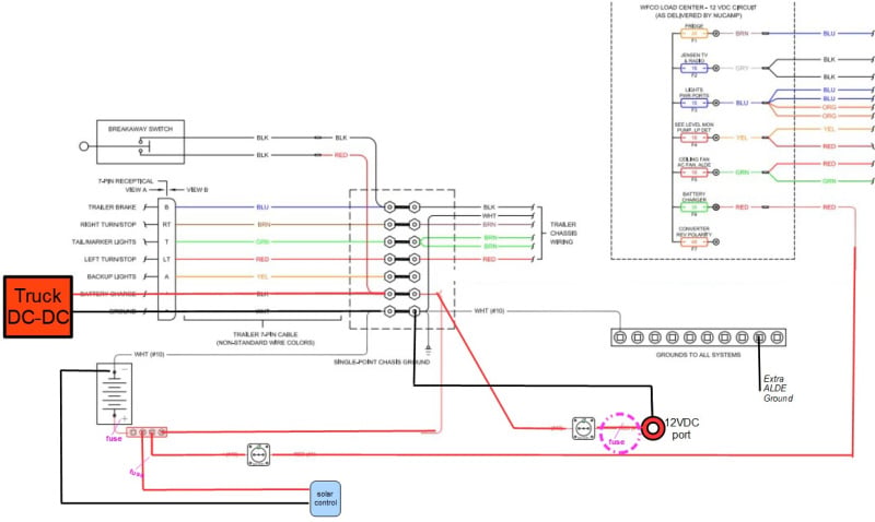

    YES, your two diagrams are correct and functional.
    Two suggestions to consider:
    1. Install an in-line fuse on the 12VDC port placed in the Tub. As that is the most likely spot to get a surprise short.
    2. Alde 3020 really don't need the extra direct ground, assuming that is what you are showing. One quality ground is all the 'after 3010' Adle needs . . but if it is already there, no big deal.
    For my visualization of your diagrams, I've edited a more standard wiring diagram. Believe these wire counts by terminal match yours . . . same real-world wiring.

    The 12V port I have purchased has a built-in inline fuse.
    The factory had installed the extra ground from the Alde directly to the battery, so I am replicating. (Other folks commented the Alde had quit working until they replicated that ground).
