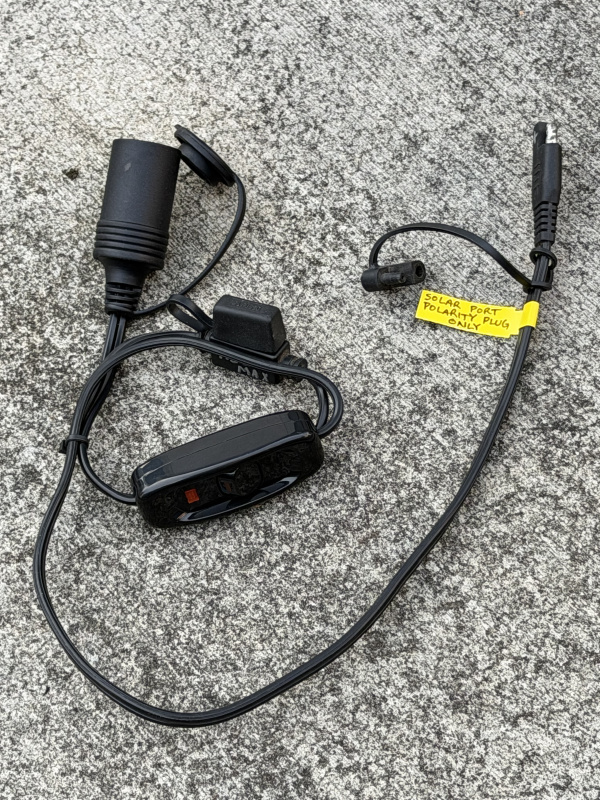

Well, I used some parts I already had sitting around and bought some new ones.
I had a female 12v outlet and in-line fuse receptical, a 12v in-line switch, and plenty of SAE connectors from 40 years of motorcycle battery tender ownership. ;)
There exist pre-wired connectors you can buy that go from SAE to 12v female outlets - but they wouldn’t work here because the polarity is backward in the solar port connector on the trailer.
So I just made my own, the SAE connector here would be opposite polarity that people may expect - so I put a little label on it, added in the switch so I could turn it off when not in use without unplugging it, and added the fuse for good measure.
I use it with this 30v step-up adapter for Starlink. You really need a step-up adapter like this when using the Starlink off any 12v system because Starlink is incredibly finicky about voltage drops and will reboot itself a lot if your 12v voltage drops down too much - as 12v systems often do. The step-up adapter raises the voltage and keeps it in a range that Starlink is completely happy with.
This adapter would also work with anything that needs a 12v outlet - but I fused it at 7.5amp so nothing really heavy duty…
