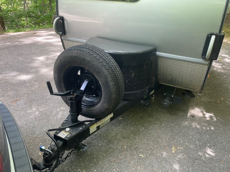

    We picked up a new to us 2014 CS-S last December and towed it home completely empty with a honda Ridgeline. We experienced the same problem severe up and down bucking like a see-saw. When I got it home, I checked the tongue weight and it was around 100 pounds. Assuming the camper weighs about 1600 pounds, we were tongue light. We recently took our maiden voyage after a renovation where I added the spare tire carrier up front to the jack. This seems to correct the problem in our case. We towed this trip with a 2007 Honda Odyssey. my thought was with the correct tongue weight, it stopped the see-saw effect. Keep in mind with gear, water, food, etc the loading can be dynamic. it is a good idea to check your tongue weight regularly.

    Thanks so much for your input on this problem! Like you I have taken the spare off the back and added to the tongue for more weight,.I will definitely get a scale and check the tongue weight. I had also been suggested to add water to the gray and black tanks, didn't help. We only experience this bouncing on certain concrete highways, other roads are fine.I had also had taken the camper tires to get balanced. Thank you again for your input! We love our camper just the same! Good luck with your camper also!
