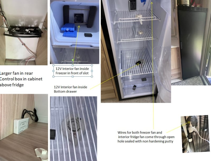

As shown in the photo, I installed a small computer‑style fan in the freezer to push cold air downward into the fridge compartment. I paired this with a second small fan inside the fridge (mounted low in the upper drawer) to improve circulation.

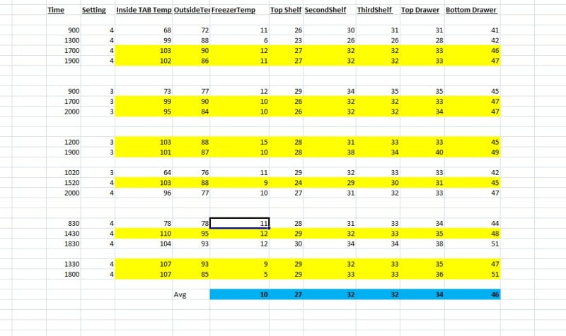

Together, these two fans have made a huge difference. Over the past week of very hot weather in my area, with the cabin getting extremely warm, the fridge has consistently held to the low to mid 30s F, everywhere, except the bottom second drawer. The data below shows the test results.

- The fridge has an existing hole sealed with non‑hardening putty that can be used to route wires to the rear compartment. Just push the putty aside and press it back afterward.
- All 12V connections can be made using the existing 12V outlet to the left of the fridge or the same connections (as the OEM fan) at the bottom of the rear of the fridge.
- The modification is fully reversible and doesn’t require altering the fridge’s structure.

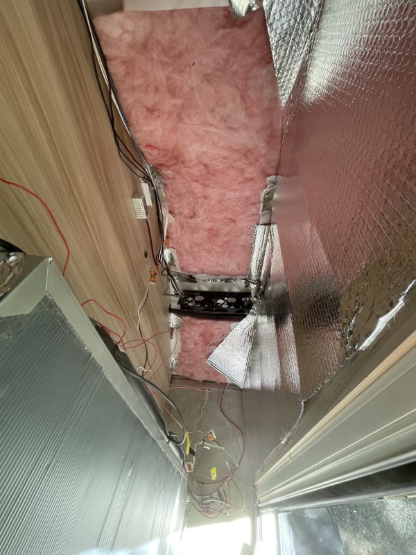

- Added batt insulation behind the fridge, plus a thin layer of insulation on the right side. The fridge cubby gets extremely hot when the trailer sits in the sun, and reducing heat soak helps the cooling system keep up.
- Upgraded the rear ventilation fan to a larger, more powerful unit. This helps create a stronger chimney effect, pulling hot air up and out of the rear compartment more effectively.

Well that looks pretty slick. Can you say more about the batt insulation product you used, and how you attached it to the curved backside of the camper?
Hi, It was "standard" attic insulation because I had a small piece available around the house. Not sure of the R value. It was a bit tricky to get it to stay in place, but I had some gorilla tape that worked. It's behind the fridge so looks was not important. I found (at Home Depot) some very thin heat barrier with a small R value to use on the right side. As you know, there is only about 3/8 " of a gap.
I have a thermometer gun and was surprised how hot the wall behind the fridge and the right wall was in the direct sun. But as I mentioned, although I have no data t support this, I beleive the fans dominant the results.
I and a few others also have placed heat barrier directly on the rear panel of the fridge. We were thinking heat from the compressor and rear coils were conducting through the back wall of the fridge and into the food area.

I just completed a second set of testing before a 3-month trip we are starting in about week. It was run on battery in full sun. I don't have any data to provide to determine how long it will run but I did not observe any increase in battery consumption from the additional two interior fans. Their consumption is small. IMO, overall battery consumption will be less because the compressor running less to keep the fridge cold.
I ran the testing on setting of both 4 and 3. On a setting of 4, the freezer ran 4 F and the top shelve was a bit cold at 24F. The upper drawer was at 35F, the interior of the TAB was 110F
On a setting of 3, the freezer ran at 13 F and the top shelf was 32 F and the upper drawer was 42 F, with an interior cabin of 107F
These were extreme tests (hot in the TAB) to demonstrate to myself that the addition of the freezer fan and lower fan is keeping the fridge cold (except lower drawer) as it should.
The challenge will be to regulate it (either with fridge setting or fan on/off) so the top shelve is not too cold. I have a toggle switch for the freeze fan so it can be turned on/off. But I rather have it too cold and play with the setting rather than to have the fridge be warm inside when the cabin is warm/hot.
The bottom drawer is completely useless as the temp rose to the mid 50s. Again, the reason for this is because the compressor is right behind it, and the heat is coming through the fridge wall.
