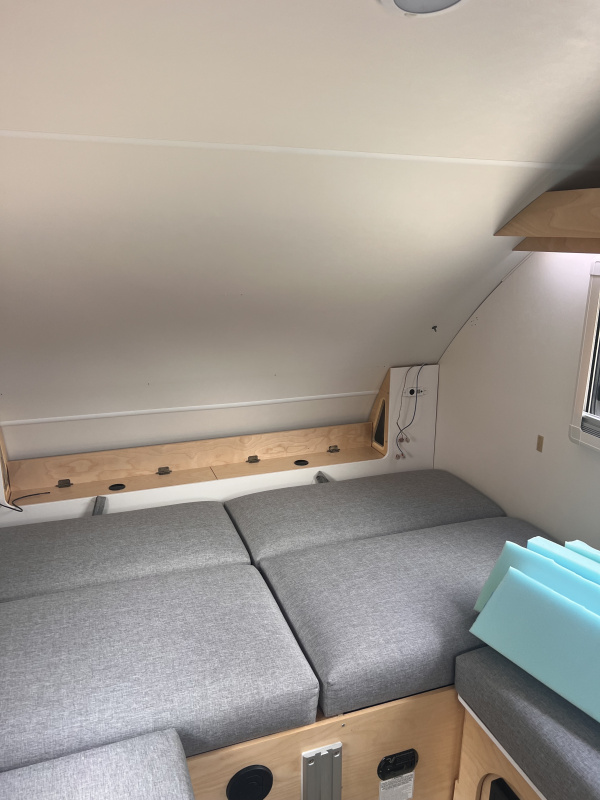

I spent a lot of time researching how others had removed their cabinets and had a good idea how to proceed. There were a number of questions still outstanding though that had me hesitant to start the project. I have now completed it and happy with the outcome one so far. We always camp in twin set up and needed the headroom for sleeping more than the storage. I tried to be very detailed in documenting the removal so others could use my experience to help guide them. Here is the link to the complete video showing all my steps. Hope it helps!

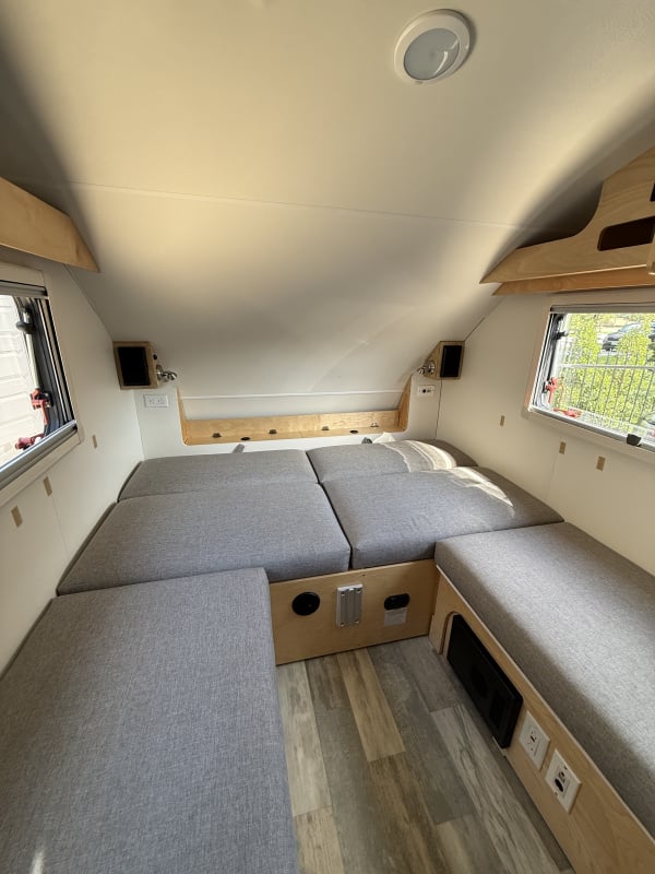

my pleasure. Hope it helps others. Here is a link to a short video I did of Building the speaker box. Also updating with a picture of the finished out result.
Nice! Great idea to mount the lights on the inside panel of the new box.

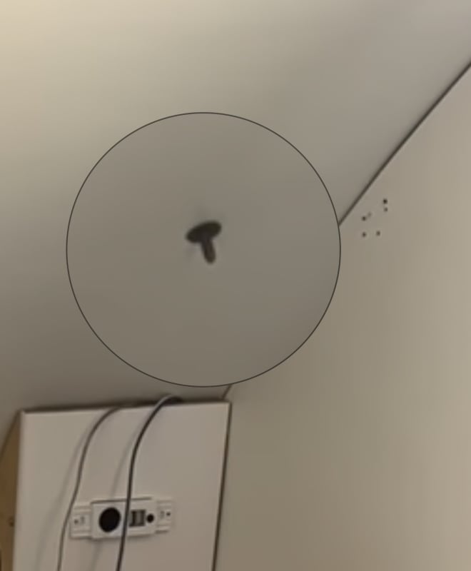

Do you happen to recall what the little dark piece extending from the back wall is? Did a cabinet fastener attach to it?
Sorry for the long delay in response. It is the bolt for the cargo racks that came installed on the boondock package for my year. It sat inside the speaker cabinet but had nothing attached to it. I left it as is and enclosed inside the new boxes I built.
