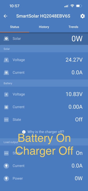

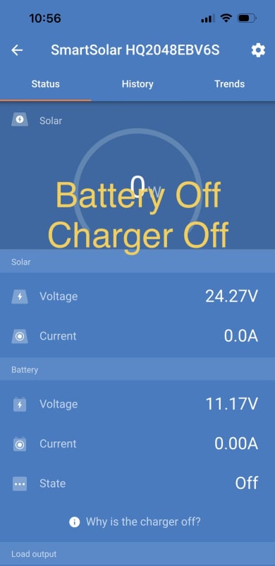

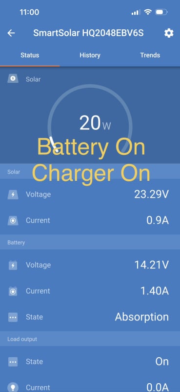

trying to make heads and tails of my battery situation. Below are 3 Victron screenshots. While the solar is on I appear to be fine. When off my battery voltage I able. The trailer has been plugged in to 30amp for 3 days with the battery disconnect switch turned into the on position. Any insight is appreciated. Nothing was on inside the camper for these readings.

A lead acid battery will "always" read "higher than actual voltage" when being charged. The "14.21V" showing on the screen while plugged in is simply showing the voltage going in to the battery. Or, "higher than actual".
When you try to take a reading with the battery in use, with no charging, even with just the battery switch on: you will get a reading "lower than actual".
Your reading with the "Battery switch off and "no charging" is the proper way to monitor a lead acid battery: the battery is in a "rested" state, and even after a few minutes all the electrons in the battery settle down to give you a reasonably accurate battery voltage for a lead acid battery.
The 11.27 volts "rested" would tend to show this battery did not take any of the charge you have tried to send it for a few days. If this battery is 3-4 years old, (which isn't too old) it may be close to failing. Generally, if the number of times a lead acid battery is allowed to drop below 12V happens too often, it can "sulfate" and be unable to hold a charge.
So, your own driveway test shows something is not good on this battery, so taking it to a parts store or running through the test Tourdefort explains, would be a good idea. At the very least: it may be time for a battery upgrade.
