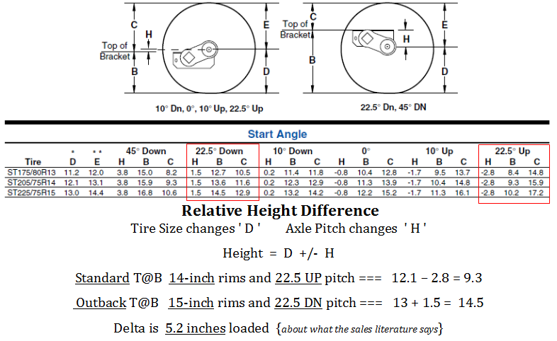

IMHO, the only realistic approach is to replace the Axle with the Boondock 'pitched' axle.
{this figure shows the axle pitch . . in the early years a Boondock was named 'Outback'}As the Torsion Axle mounting method does not allow 'added blocks', etc that is possible with a leaf spring axle.

At least the older axles had custom mounting flanges which didn't work with the usual lift blocks/spacers. Hence using a Boondocks axle was pretty much the only solution aside from completely redoing axle mounts etc.. This might have changed recently but I only know for certain that 2025 400s use off the shelf axles.
