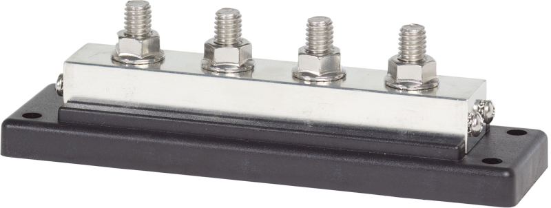

I would replace the single distribution stud with a BlueSea power bus bar, with a cover. Stacking more that two terminals on a stud isn't recommended. Same for the negative side if that has three or more terminals.

Rich, n looking at the bus bars they come in different amperage's, do you know which amperage would be best for the T@B400?

Though probably overkill, I would get one that has the same post diameters as the single one you have now. That way all the cable ends will attach with good contact.
