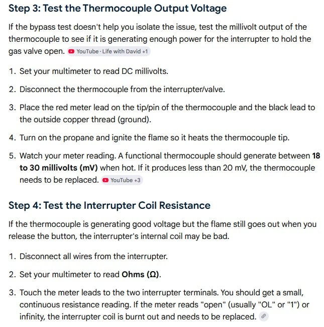

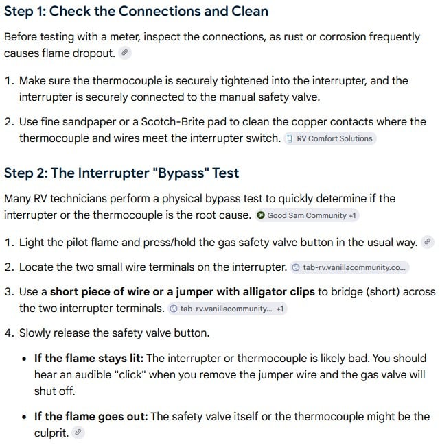

Are you 100% sure the Relighter Module is bad?
Poor placement of thermocouple tip in flame, dirty tip, or just bad thermocouple should be eliminated.
Also, confirm the "interrupter" is good and has good electrical connections.Have you read/seen this Forum Post on Interrupter
A google AI search:
" how to Test the interrupter component of the thermocouple circuit on a norcold 3136 relighter wiring "

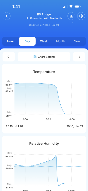

I'm changing out my norcold 3163; it would ignite, but not cool. If you want the igniter module you can have it, just cover shipping. PM me if you're interested.
sent a PM.
Bassaholic: Received your "old" igniter last night and installed this am. A heartfelt thanks as working perfectly. I do not use the propane fridge often, but want it, when I want it.
