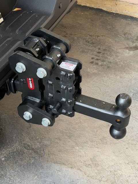

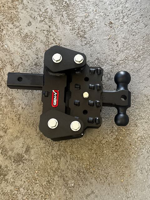

@RTWCTS So for your new TV did you get one of these? I use a Toyota Tundra Hybrid and it made a significant difference in towing my Tab 400. I just got the extension but have not used it. Will share more about that after using.
This is the extended tow hitch, same as the previous one just sticks out farther which should give it a better turning radius without hitting the corners of my truck. Did I say I loved the Gen Y hitch? I love it!!!
Be aware that hitch extensions dramatically increase the bending load on the hitch receiver and vehicle interface points. As a result, you need to reduce the tongue load by 25-50%, depending on the extension length. If the tow vehicle tongue load limit is 1000 lbs, no worries with a 400. If it's 500 lbs, then you need to be careful and reconsider using one.

No, we have been using a B&W stow and go hitch on our truck. When folded under, it allows the Chevy multipro tailgate drop step to open so my 'old arse' can get into the bed of the truck easier. Your hitch looks very impressive though!

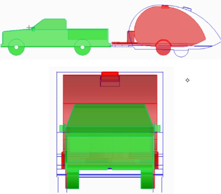

Great visual reference! What program/app did you mock up this reference in?
2025 T@B 320 S BDBC
2024 Jeep Grand Cherokee Overland 4x4
NE Indiana0 -
onShape online CAD
@MuttonChops Thank you! I had access to AutoCAD before retiring. It would be nice to have access to a simple 2-D cad for my "government projects". I will check it out = thanks again!
