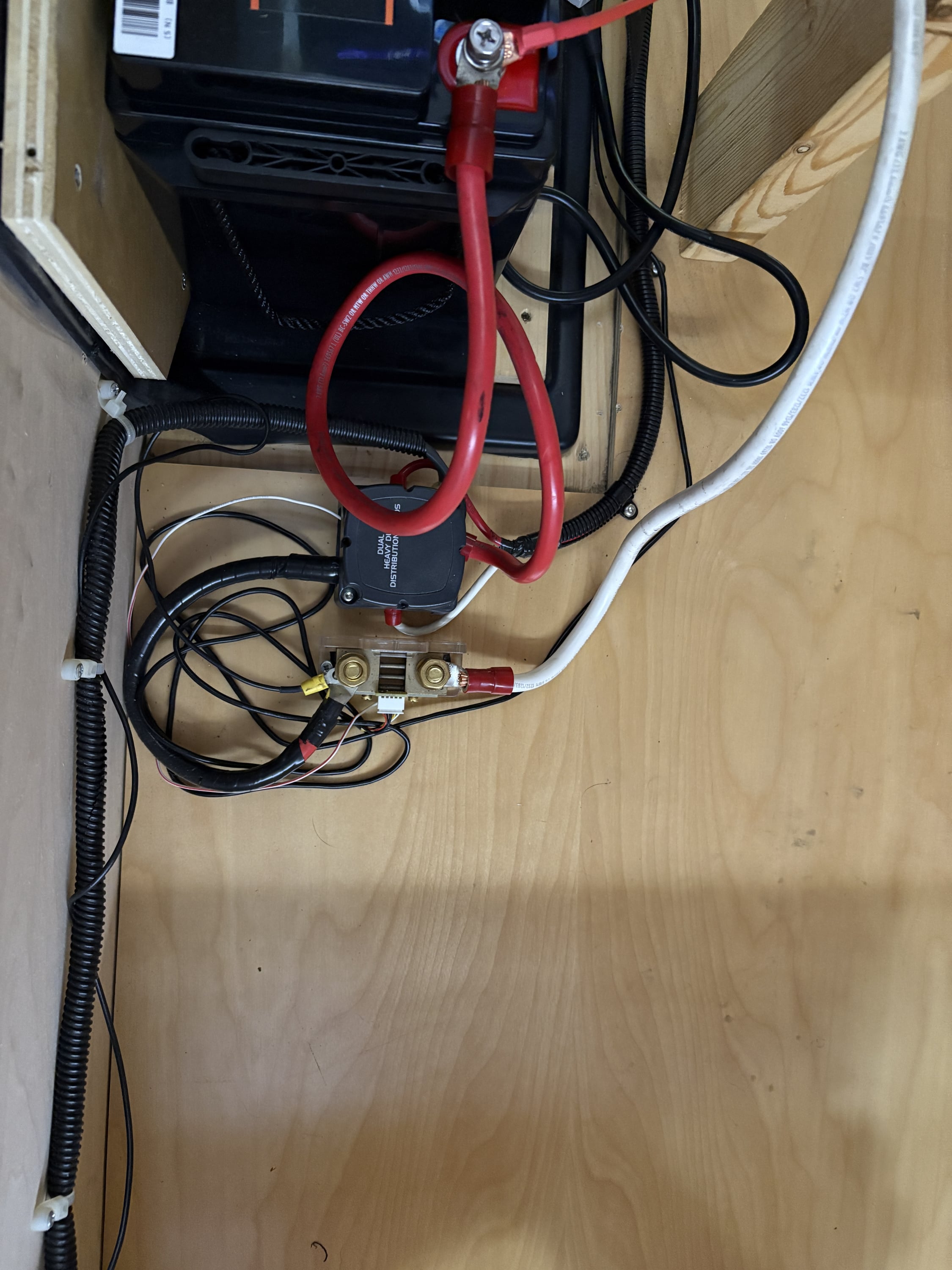

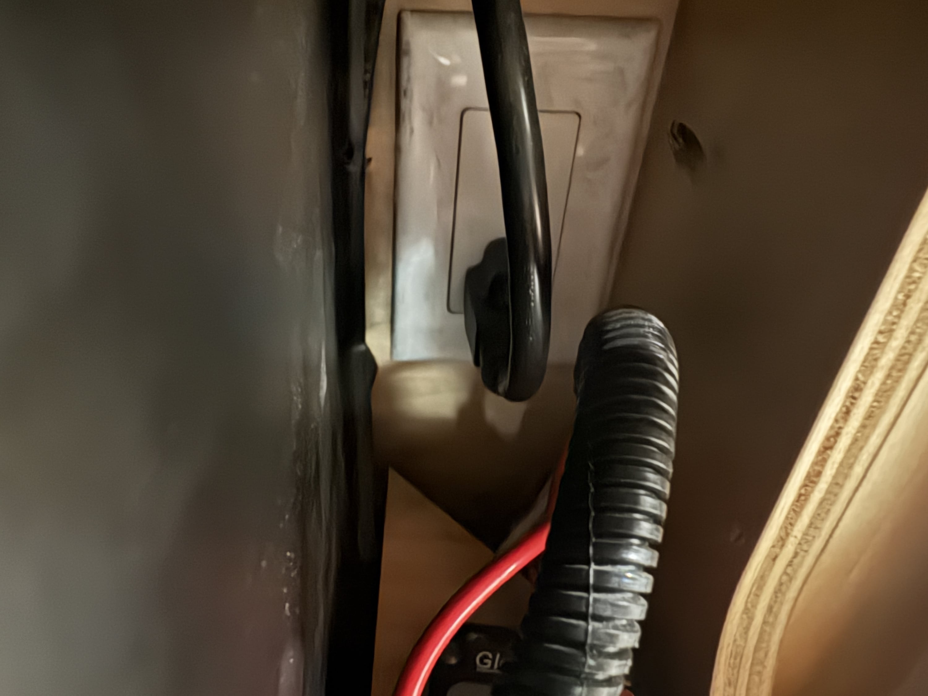

    @FriendsofMario We also have a 2019 400 and we changed out the AGMs as well. You have to remove that battery box and that is a pain. The bed panel on the passenger side also needs to come up. When you have access you should disconnect the negative terminal first for safety and of course keep the positive and negative wires away from each other and any grounds.
    Those AGMs are heavy and the new AGMs will be very heavy. If not able to lift out then one member laid them on their side and slid them out the passenger access door. Dropping the new ones in is just lining up and reconnecting positive first and finishing with the negative. The existing cables should fit the new AGMS just make sure you put them in series (+ to -) so that you have 12 V where your connect to the trailer cables. That is the limit of my electrical expertise so others may have some better ideas.

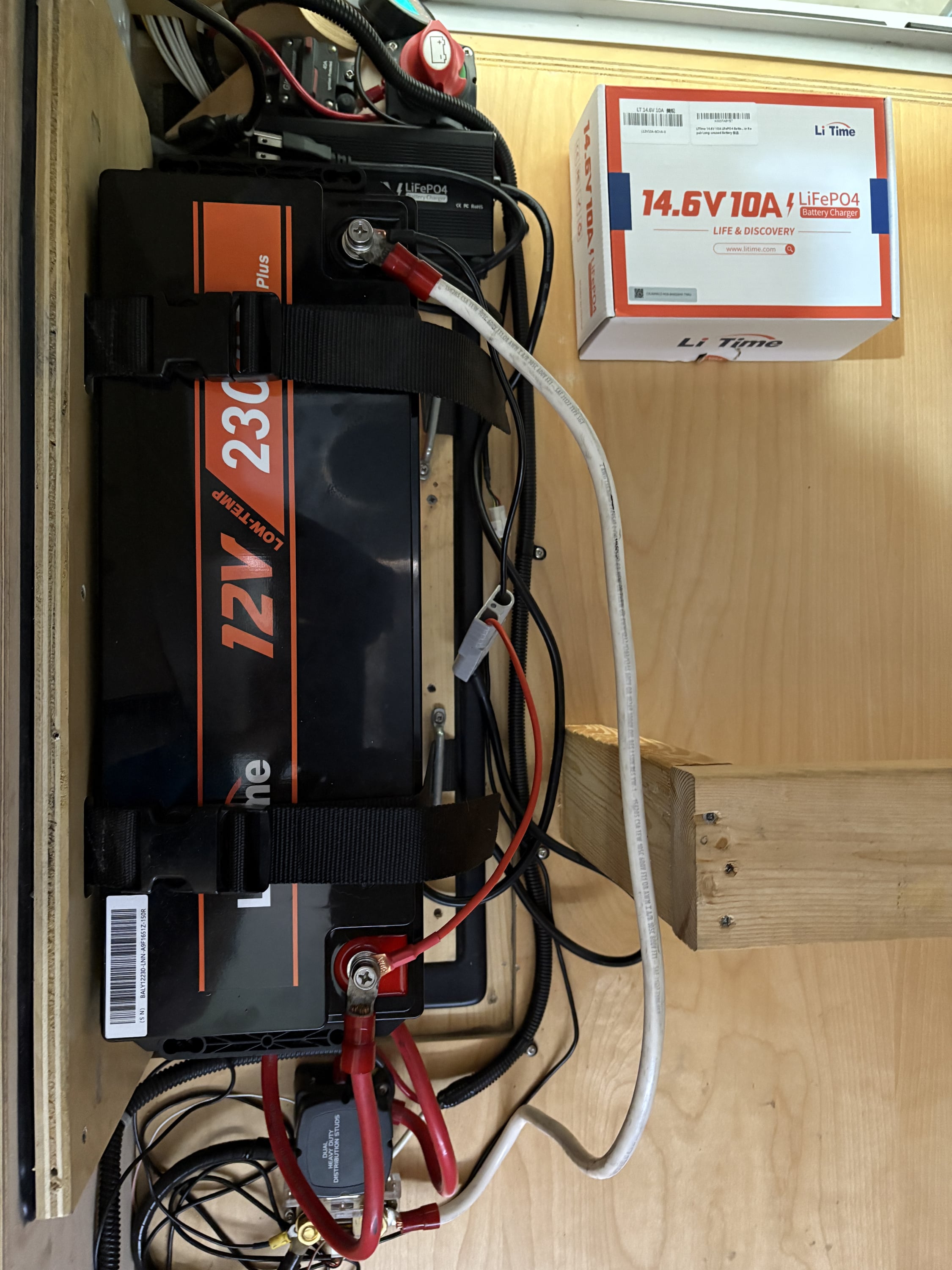

    Having said that I would want you to consider a lithium replacement if you have not already. Price not significantly more and capacity and life much longer, plus nearly 90 lbs lighter. You can get a 230 Ah or a mini 300 Ah now. We love our 230 Ah LiTime and it was nearly a perfect fit with some left over.
    And if you have the smaller frig you may gain a 20A plug tucked away near the battery disconnect. We use that for the small Lithium charger when on shore power.

    For our 2019 400 once I found the AGMs were losing capacity so that we could not be off shore power for 3 nites running the 12 V frig, I started looking at alternatives. There are a LOT of choices now and when I last looked the price difference is really not that great unless you get what I will call an "influencer lithium". The orginal dual 6V AGMs Harris batteries had a 224 Ah rating, and you were advised to only draw it down to 50%. I swapped for a LiTime 230 Ah with low temp protection and found it was nearly a perfect fit in the space with a little space left over on the end.
    I can draw this one down to 20% over and over again with no concerns. It was very easy to lift into place and secure. I did NOT have to wrestle with the battery cover, and I discovered an extra 120V plug on a 20 amp circuit near the hatch that is used for the 12 V frig normally when on shore power. I used a splitter on that to make a tap for my small Lithium battery charger that I plug in when home to top off the battery. I did not change out the WFCO. My trailer did not have solar but is wired for a solar suitcase so that in the event I need to charge to 100% when off grid that solar controller has a lithium setting and can do the job. Zero problems with the setup. Wish I had done it sooner. My 2 cents.

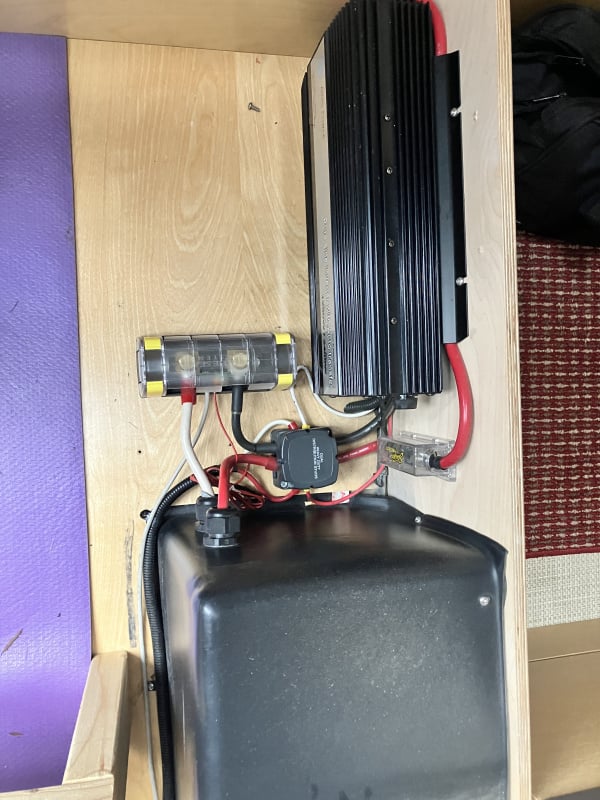

    This turned out to be rather less difficult than I had anticipated. Here are the steps I took after removing all of the bedding:
    1. Remove the center and then the passenger-side bed platforms. Simply unscrew the hinges and lift off. This is also a good time to lift up the driver's-side bed platform and remove the fuse from the solar array. This 30A fuse is located just below the solar controller which is mounted on the bulkhead next to the 120V outlet for the ALDE.
    2. On our 400, the final 12" or so of the kitchen counter is hinged (I don't know if this is the case for all 2019s or not). I simply unscrewed the hinges from the cabinet and removed the drop-down piece. This proved to be the key to the whole r/r job. With the portion of the countertop that is directly above the battery box out of the way, I could then both work on the battery box and remove/replace the batteries from directly above. Here's what you'll see:
    4. Next remove the battery box. This is the most time-consuming part of the job. There are 4 screws along the top edge of the box (they screw into the bulkhead of the bed platform), one on each vertical side of the box, and then a total of 8 (I think) around the perimeter of the box where it meets the floor. Note: along the front edge of the box there are screws which hold the flexible black plastic conduit to the floor, and then there are screws at each corner which attach the actual battery box to the floor. Additionally, there is a scew right next to the circuit breaker that sits just behind the battery disconnect switch. Make sure to remove those three screws…

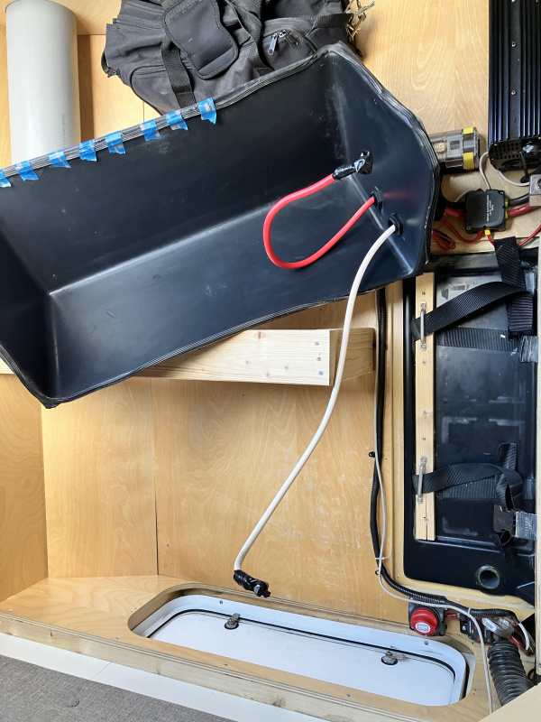

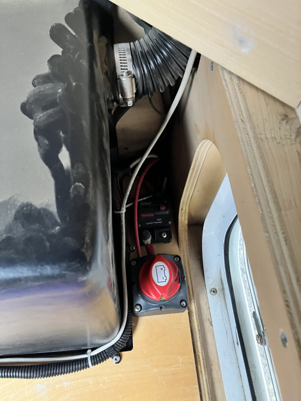

    Also you'll see the corrugated plastic tubing for the vent (right side of above photo). Take the hose clamp as loose as you can, work it free of its deathgrip on the battery box, and slide it out of the way. Pull the vent tubing loose; I had to wiggle it back and forth vigorously several times until I was able to pull it off: I then let it just hang down straight out of the way.
    5. On the left side of the battery box you'll see where the battery cables penetrate the box and out to the terminal block. These cables pass through liquid-tight connectors. Loosen both of those and slide them out of the way. Doing this will allow you to rotate the battery box when you finally pull it loose in the next step.

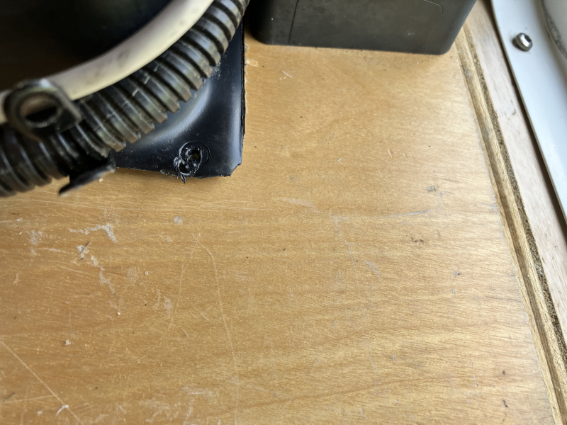

    6. The right front corner of the battery box, where it meets the floor, is actually tucked under the floor where it is cut out to accomodate the box. Push against the lower right front corner of the box to get that edge to pop out. (See photo below.) The upper right corner, meanwhile, is tucked up behind the edge of the wall that's under the aforementioned hinged countertop dropdown. Push down on the upper right corner of the box, hard, while pulling outward at the same time, so that that edge comes free.

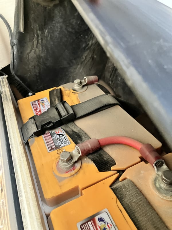

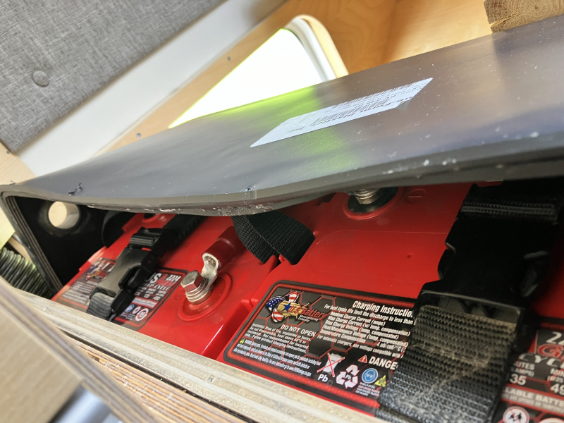

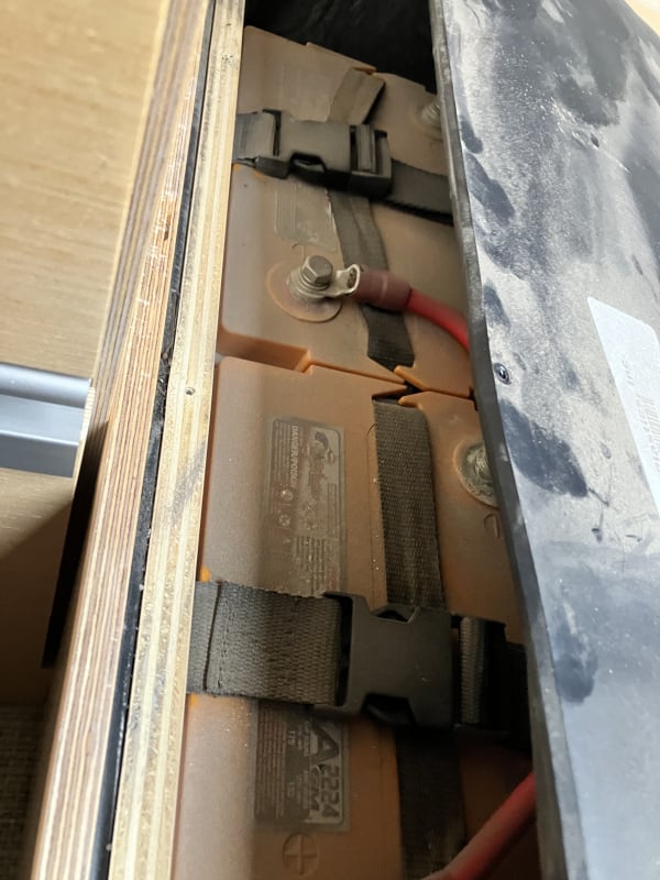

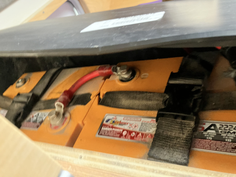

    7. Now you can pull and lift the box outward, and rotate it up and out of your way. You'll be looking at your old, factory-installed AGM batteries:
    Surprise! Not two Harris HBDAGMGC6-A, as we expected, but two USBattery 2224s. But that's fine, because we went with an exact, drop-in replacement. Note all of the dust and dirt in the battery compartment and the underside of the battery box itself. Some of it is dust and dirt, but I believe that a lot of it is electrolyte that boiled up, escaped, and resolidified. The positive terminal of the near-side battery was pretty corroded, and once I had the batteries out, I saw that the leading edge of both cases showed a consistenly thick, even covering of the same material.
    8. Take off the batteries' seatbelts, disconnect the positive cable on the near-side battery, disconnect the jumper between the two batteries, and finally disconnect the negative cable from the far-side battery. Pull each one straight up and out.

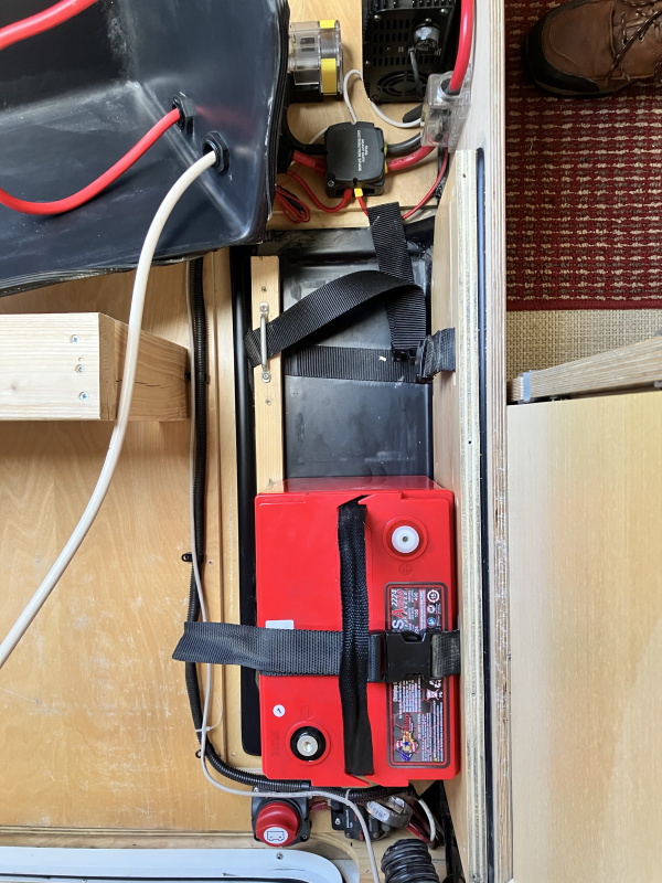

    The rest of the job consists of reversing these steps. Here's what everything looks like cleaned up:
    The pieces of blue painter's tape are acting as gravity mitigation devices. The battery box is gasketed around its perimeter, and a long section of this had come loose. I used Lexel silicone adhesive to persuade it that it wanted to remain where it should be. And finally, the new batteries in their new home:
    While I had the batteries out I took the opportunity to tighten all of the terminals on the shunt and terminal block.
