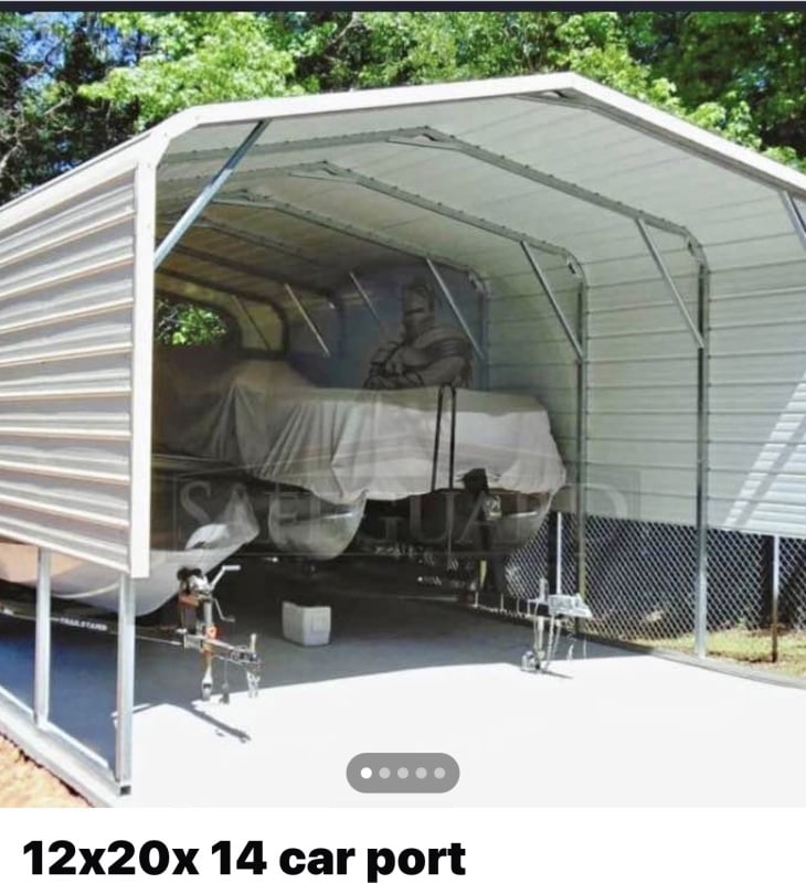

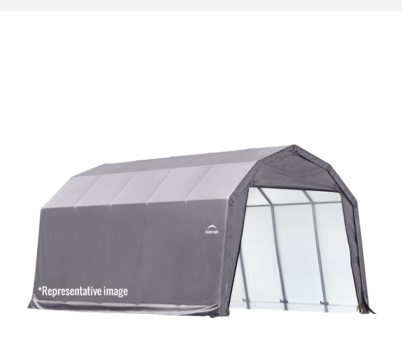

I’m looking for advice/recommendations for a tried and true rv-port.
I’m looking into getting a garage type carport for my T@B.
Somthing like the images below.

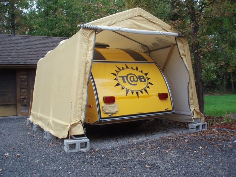

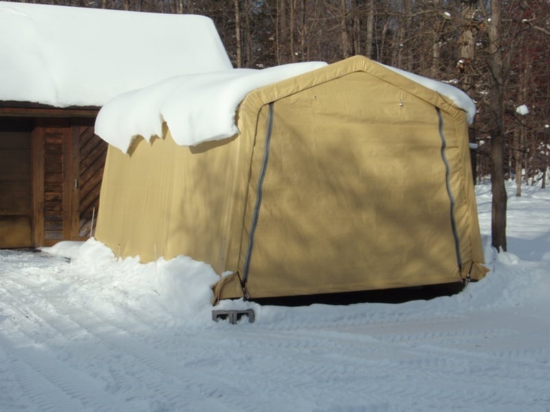

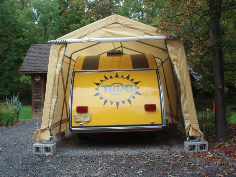

It was a Shelter Logic model sold by Harbor Freight. The concrete blocks added needed height and helped anchor it. I also added a few diagonal wood braces to stabilize the framework.

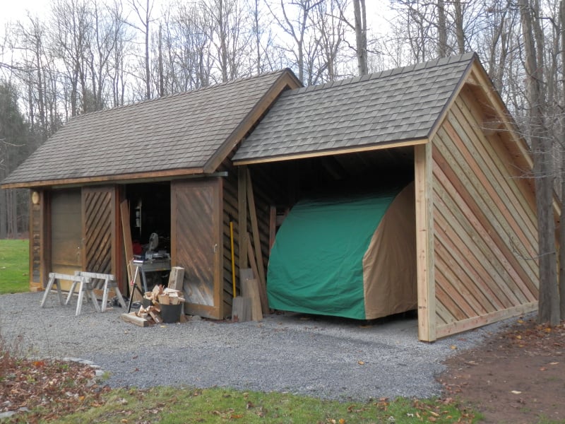

The thin fabric on this economy model started to fail at the high stress points at the frame corners. Overall a good investment IMO. By the time it was to replace I built a more permanent solution.

Thank you so much for that information. I love the permanent shelter you put together. That is way cool!
