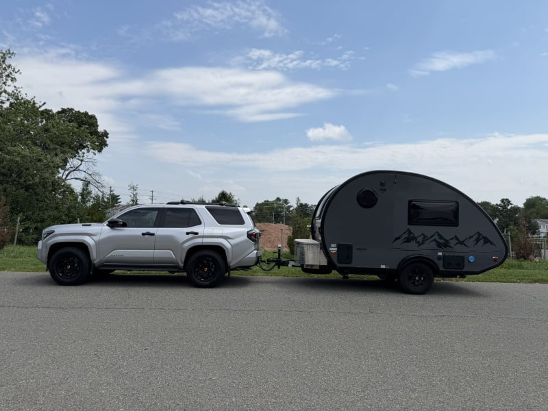

I just got a new tow vehicle and swapped out my old drop hitch. I am trying to decide whether the slant is too much or whether I should have a new drop hitch made with the proper friction sway bar tab welded on.
Should I…

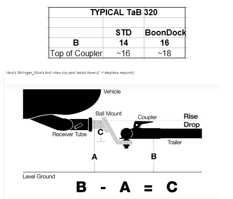

    Measure your rig and make an informed choice.
    Basic rule-of-thumb; if standard drop/rise tow bars do not match your required drop/rise for level rig.
    Then select the one that places the Trailer Coupler Lower not Higher as lower helps control trailer sway when compared to being higher than ideal.
    Reference picture, measure trailer when level and not attached to tow vehicle [TV]
    Measure TV when level and ideally loaded with it's normal camping stuff, knowing or estimating TV rear sag can be helpful as well.

    Go with this drop hitch. It is fine.
    Looks good to me, if anything the tongue might come down a bit with the 4runner and the T@b loaded. If the trailer is not noticeably nose high or low I would not worry about it.

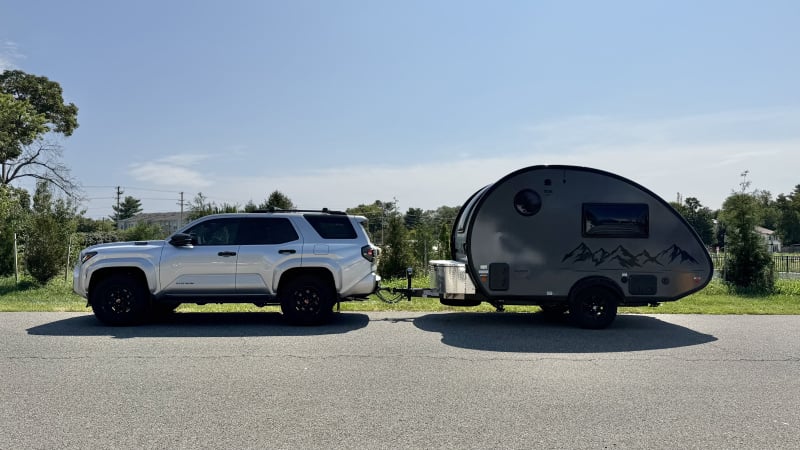

    I added airbags and got a 4-inch drop hitch. I might be able to lose a slight bit in the air bags, but right now now the vehicle is empty. When it's loaded it will probably level out by dropping an inch or so more.

    Looks good to me. I'm jelly you can install air bags in the 4Runner. Our Highlander can't accommodate them.

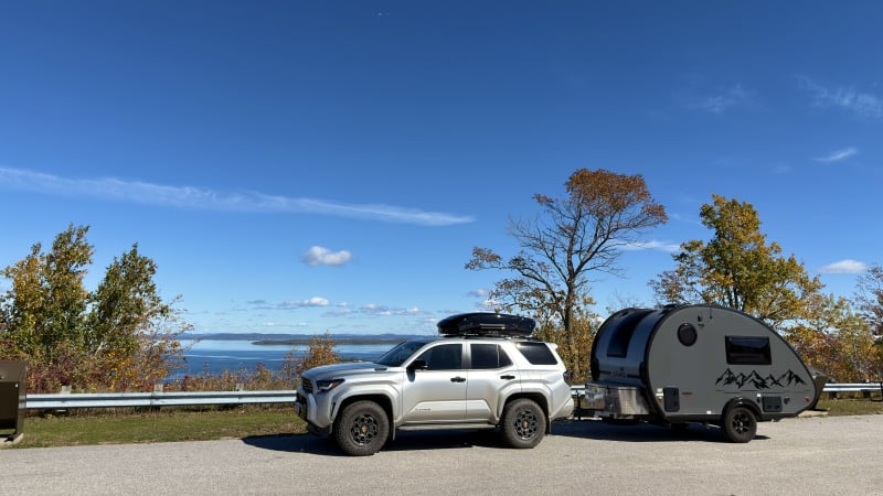

    1,500 miles from Washington DC through Niagara Falls to Killarney Provincial Park, South Baymouth, Tobermory, Bruce Peninsula, and back home. 20PSI in the rear airbags. Everything held together perfectly. The hybrid engine was powerful. The suspension was good with about 400-425 pounds of tongue weight. (I wanted to get the tongue weight down, but to no avail.) Traveled dry.
