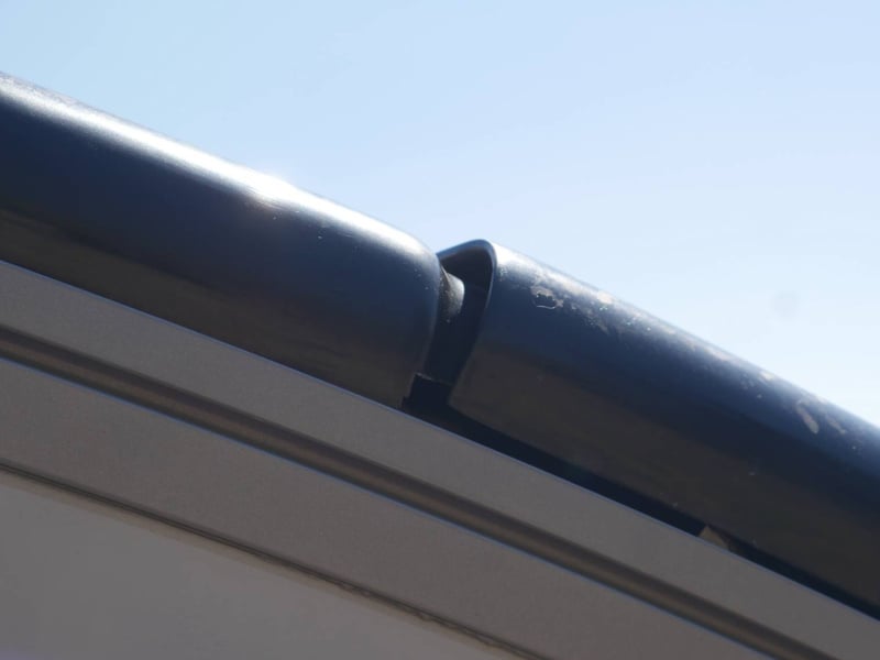

Greetings fellow Tab owners! Can anyone provide help on how to repair this loose piece of trim on a 2021 Tab 320 Boondock. Maybe remove the trim and replace a fastener or something? Thanks a lot for any info. My Tab is pretty much perfect except for this and of course it drives me crazy.

    On my 2015 that outer piece is held down by a small screw driven in from the top. The plastic around the screw hole is a prime place for cracks. If that's the case with yours and the cracking is not too extensive, maybe try putting a fender washer under the screw and see if you can get it to reseat?
    And if you come up with a better idea, please tell us about it!

    I had the same problem on my 2023 tab 400. It’s a design flaw as there is only a small screw and a very thin section of plastic holding it down at a stress point. I contacted NuCamp but since I was just out of warranty they didn’t help me out. I temporized by drilling self tapping screws through the bar and caulking around them but they eventually failed also. So I was forced to bring it to the dealer. It needs to be fixed to prevent potential water leaks.

    This has been an issue on the 2021 320.
    Search: 2021 320 trim lifting out at rear bend

    Thanks for the advice. I'll have to check again because I did not see a screw holding that thing down from the top. I'll get 'er done one way or another.

    I put in a ticket with NuCamp support to see if they will provide advice. There are no screws on the top of the rail that can be replaced. There must be a way to slide the entire section of rail to remove it from fasteners or pop it off somehow. I'll post if and when I receive a response from NuCamp. If they don't respond that's a sad situation.

    Things changed for the 2021 and later models. The black plastic trim is not held in with any screws. The trim fits inside of a thin groove that is on top of the keder rail and it's held in by adhesive and metal clips that fit inside of the groove.
    Removal isn't real easy. Run a sharp blade in the groove along the outside of the trim to break loose whatever adhesive you can. Then you can pull up on the black trim while getting a flat blade screwdriver in the groove under the trim and prying upward. It's a bit nerve wracking, hoping the trim doesn't crack.
    After removing the offending trim pieces on mine, I spent some time with a spokeshave to improve the fit within the groove. I think on the first iteration (2021) the curve of the trim piece didn't quite match the curve of the trailer. Then I carefully cleaned the groove with a manual grout removal tool and razor blade, cleaned it with mineral spirits, reglued the trim piece with adhesive, then taped it all down with blue painter's tape. It's held for about 30k miles over lots of rough roads and high winds on the interstate. I still check it regularly.
    The trim in purely ornamental. There is no breach into the skin so the condition you show will not cause any water issues. However, several people did have that piece of trim fly off while traveling down the highway, so it could cause a hazard for other travelers.

    Thanks a lot for that very helpful information. I'll be able to secure that loose piece and not mess around with removing it unless it gets worse.

    Wow thanks for the feedback. Nice Tab! The instructions for that awning had me worried so I'm glad to hear it's not difficult to set up. I've got to go out in the yard and practice setting it up. For the loose trim, see Wayne W's really good info in this thread. I'm gonna go with some good epoxy to glue my loose trim down, now that I know the trim is just glued to the top of the trailer.
