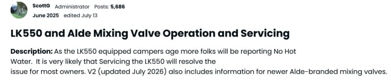

Several forum threads on this issue, try the Search Feature or check the resources section for Mixing Value Service

First you should read: Low Hot water pressure

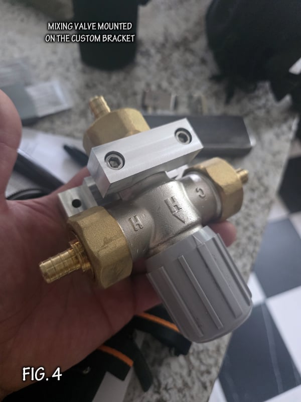

The valve that I used: Mixing valve

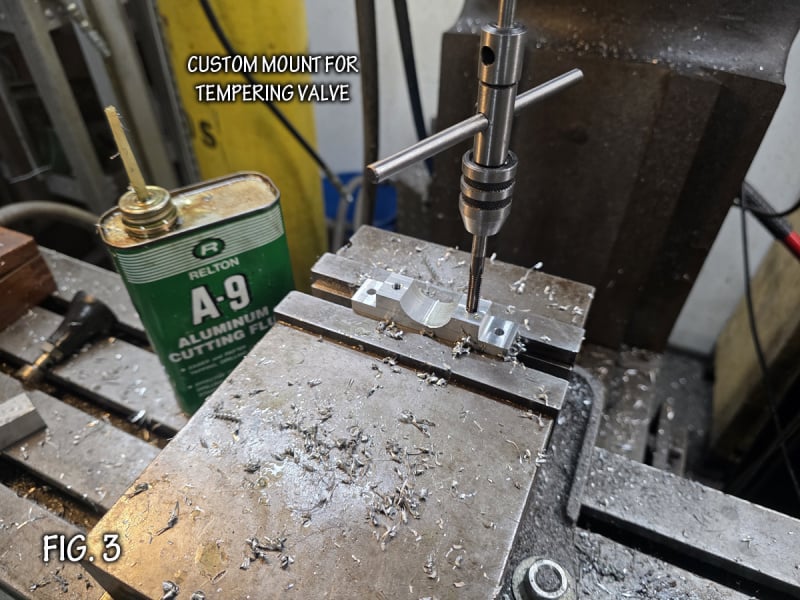

The mixing valve does not come with a mounting bracket, however you can buy the same valve with a panel mount nut and make your own bracket for it. I made a custom bracket from 6061-T6 aluminum because, well…I can : )
The Alde mixing valve does not come with a bracket either and the folks at NuCamp just used tubing hangars to mount it. I wanted something solid and also wanted to clean up the mess that is left by the rapid production line at NuCamp.

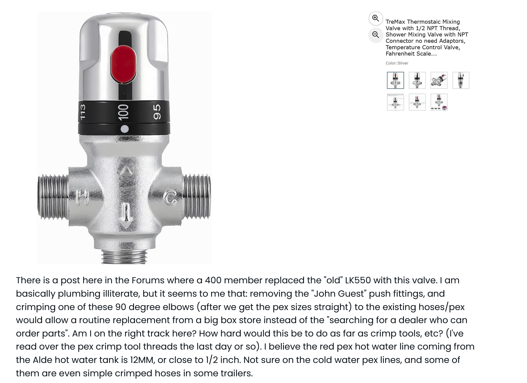

There are one or two other examples of owners who have dumped the Alde valve for something simpler and readily available. Several owners have used the valve below in their 400's, and the same valves shows up on Amazon with different company names. This is a comment I posted back in July with the valve pictured:

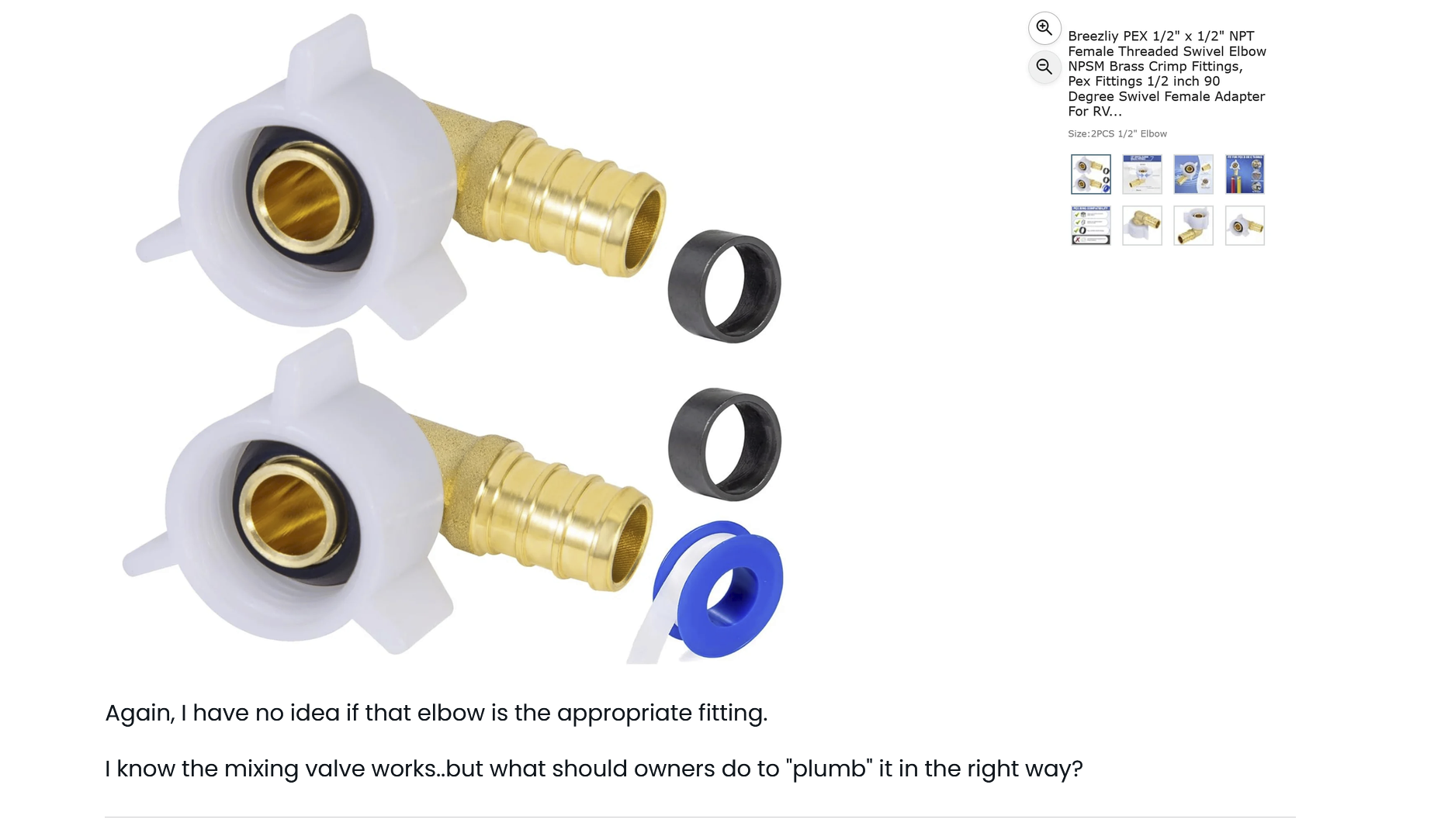

My question would be: is there a mixing valve out there that uses the same style/size John Guest fittings we have in the newer trailers? Would those "swivel" adapters in my comment work on the "Tremax" valve as long as they were appropriately sized? (Epods solution in his thread about the mixing valve is much nicer, however.)
What is sort of surprising to me is we see about one failure or issue with the "new thermostatic mixing valve" per week, it seems. The "old" black cap LK550's rarely fail to deliver hot water, it seems, but they do/did have issues with leaks.
