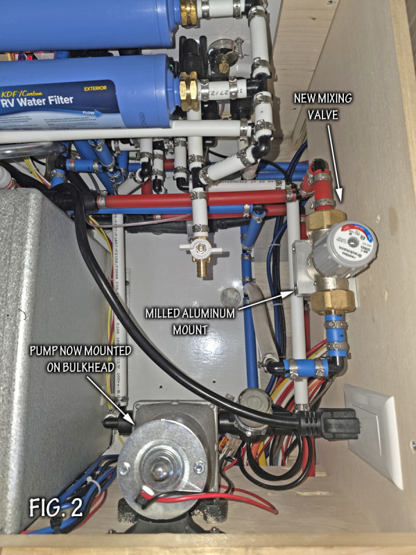

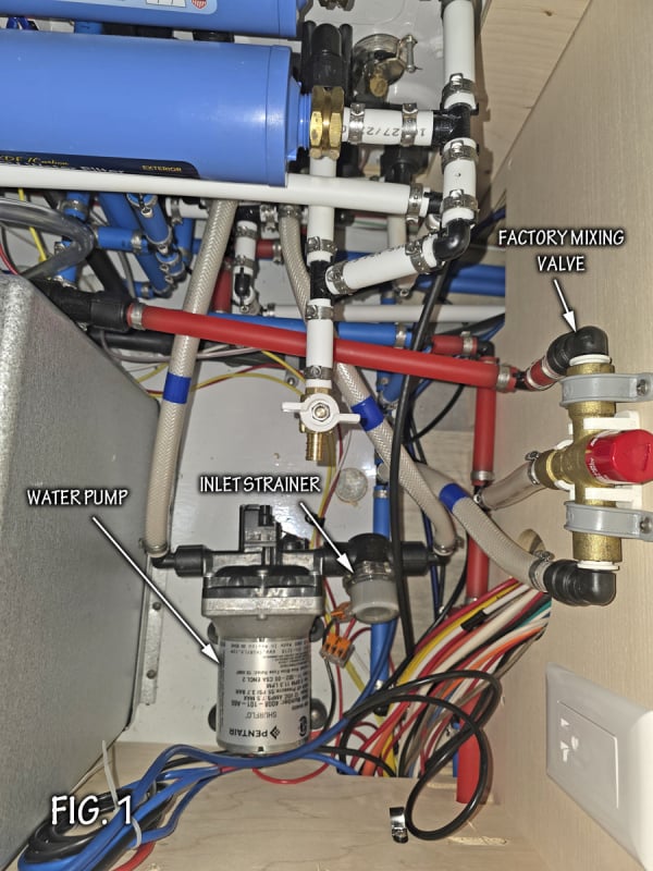

    I have a bit of a background on hot water machines and well, building stuff. The under bed compartment now looks nothing like how it was when I purchased the trailer. It is important to have access there but one of last years mods included adding a size full Purple mattress. The mattress is another story and now that I can't camp without it, it is a heavy mattress to deal with. That makes going under the bed into the equipment space a bit of a chore. Not to worry though, I have a fix for that coming but lets focus on the hot water issue.
    You guys were spot on when you pointed to the Mixing valve, also known as a tempering valve. I went to go and service the one that is in there but then decided to put a "real" tempering valve in instead. And like everything else that job snowballed into cleaning up the space and finally moving the water pump to the bulkhead where it belongs, so that you can clean/drain the strainer on the inlet side. When I first opened that inlet strainer I was a little disturbed to find what I found: The screen was black from oxidized manganese or iron bacteria reacting with oxygen. The reality here is: The removable cover needs to be in a place where you can drain and remove it.
    So I moved the pump, added the new tempering valve and the problem is fixed. I have a solid stream of both hot or cold water at all spigots including the shower.
    Figure 1 shows the mixing valve and water pump (as-found). The other mods in this space are for a post on another day. I noticed that the suction line on the water pump was a hose that often collapsed so changing that out to Pex was a must.
    Figure 2 shows the valve installed and the pump moved with new plumbing. I am able to put a little plastic tray under the inlet strainer to drain it for cleaning. The Resideo Braukman Mixing Valve that I added is the same that I use in salt water systems and seems to last forever. It also has a much finer mixing resolution to get that precise temperature that you want.
    As you can see there is more room in the space and it is a little cleaner. It is clear that these trailers are assembled by people pushed to get them out the door. The haste is obvious in the way the fasteners were buried in the rubber mount for the pump and the crooked angle that it was mounted (as-found). I plan on coming back to this space to make more upgrades and fixing factory flaws. But for now: PROBLEM FIXED!!!!.
