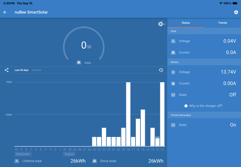

Here is a screenshot of the MPPT history

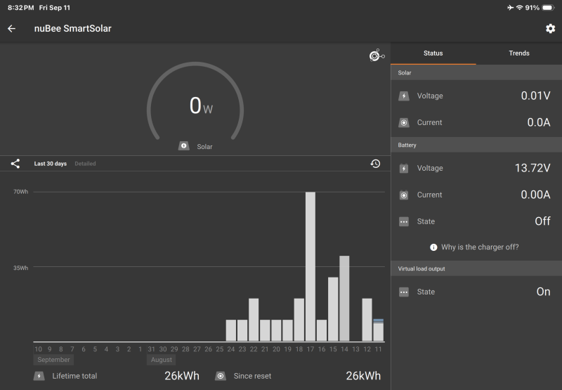

    Our 2025tab 400 bd solar panels went bad and are currently being replaced by the dealer. Could you show the app screenshot where it shows hourly solar generation chart from a clear day? We found that our panels won't charge in the middle of the day between 12-3pm. In California also. Fell free to message me

    Here is a screenshot of the last 30 days

    That screenshot actually helps narrow this down quite a bit. The MPPT is showing only 0.04V PV and 0.00A, while the battery is at 13.74V, so the battery side appears to be connected but the controller is basically not seeing the solar array.
    Since you mentioned the solar output had been gradually declining even during clear days, I’d troubleshoot the PV side before assuming the MPPT has failed. I’d start with the PV disconnect/breaker, fuses, MC4 connectors, and the roof wiring. If you have a multimeter, check the PV voltage directly at the MPPT while the panels are in full sun. If there’s no meaningful voltage there, work backward toward the panels and wiring. If you have proper PV voltage at the controller but it still reads around 0.04V, then I’d start looking more closely at the MPPT.
    I’d also check the Victron history/logs to see when it last detected PV and whether the output was progressively dropping. Since the system was producing around 26kWh previously, it clearly has worked, so I’d look for a failed connection, fuse, disconnect, or other PV-side issue before replacing the controller.
    I’ve also been looking into solar panel kits from Off Grid Stores for a separate setup, and one thing I’ve learned is that checking the actual PV voltage at the controller is one of the quickest ways to separate a panel/wiring problem from a controller problem. I definitely wouldn’t replace the MPPT until that voltage check is done.
