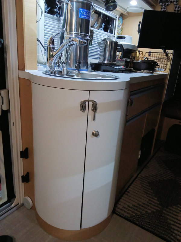

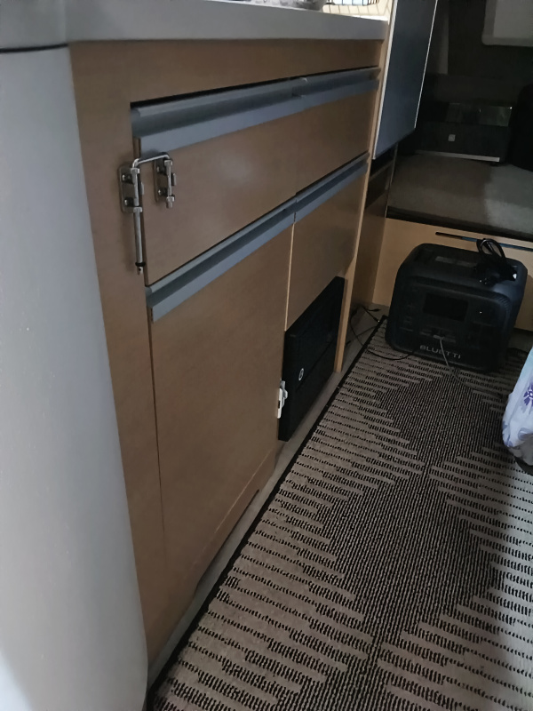

Here is what I've done to fix this issue.
