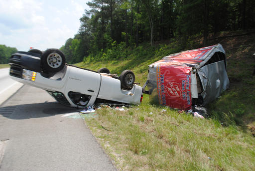

Along with trailer weight you also want to factor in the occupants of the vehicle and gear/cargo hauled in your vehicle tow rating. Things do change during travel, traffic conditions (congestion, inconsiderate drivers in front of you, etc.), weather needs to be factored in and road surfaces as elevation and grade (as noted earlier) place a huge strain on the transmission, things begin to heat up and wet road surfaces make it difficult to stop a vehicle pulling a trailer. I've had loads push me while trying to stop various trailers and loads I have hauled over the years and have seen some terrible consequences via accidents when others lost control of their rigs. As noted, you can probably pull about anything with any vehicle, but having the right vehicle that is sufficiently/adequately rated for the load and that is capable of doing so 100% of the time is the best way to go. Safety is the ultimate goal and protecting yourself and your family should always come first and foremost as things can and do happen when you least expect it.......
