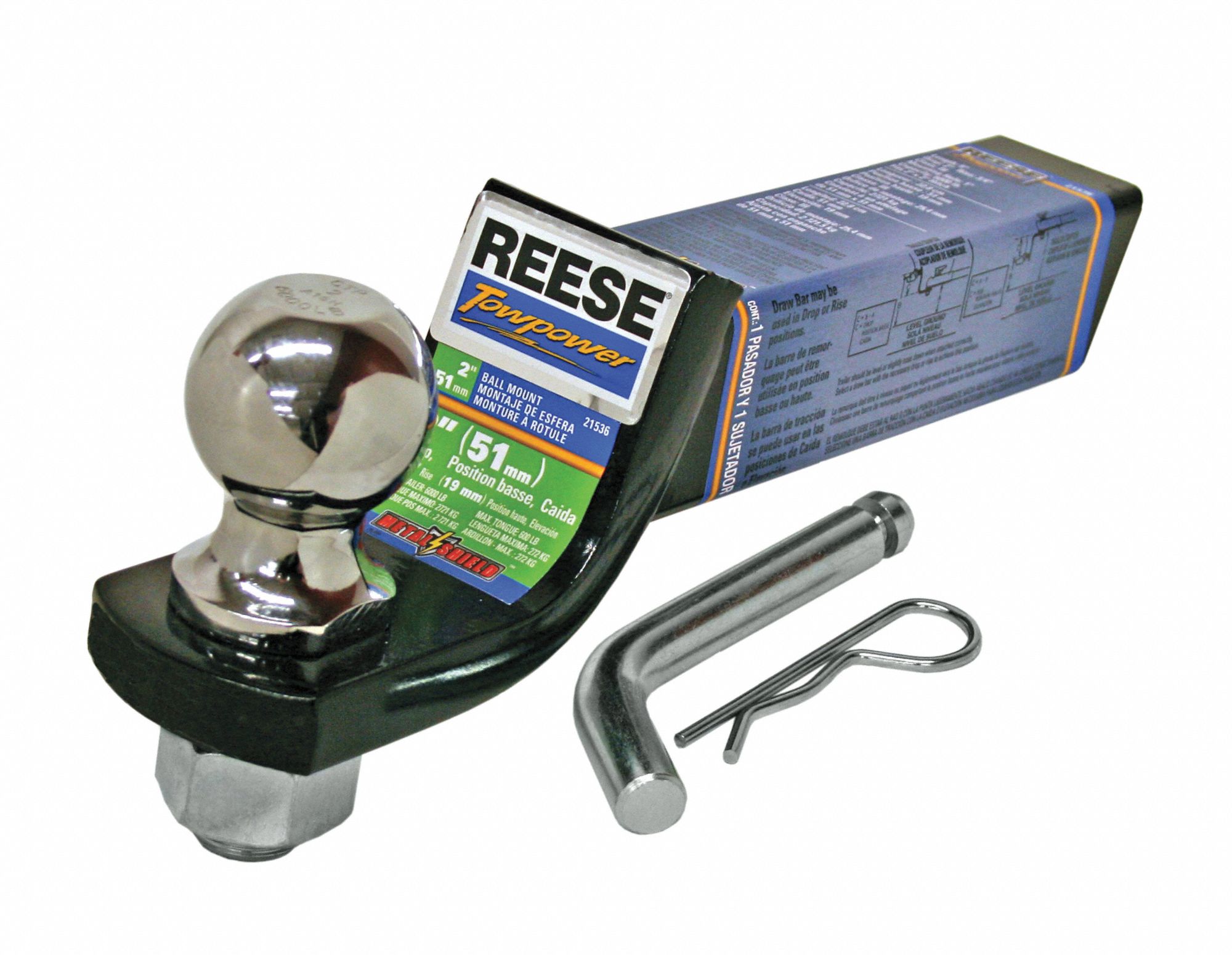

Trying to determine what I'll need. How do I figure out the shank length (sm, med, large)? Or perhaps that's not necessary and I just go with a "starter kit" like this (I believe I only need a 1" drop and everything I find is no lower than a 2" drop - I'll measure again to be sure).
Starter KitBlackIII Class
Compare
  • REESE
  • Starter Kit, Black, III Class
  • Item # 20PV24
  • Mfr. Model # 21536
  • Starter Kit,Ball Size (In.) 2,Hole Dia. (In.) 1,Class III,Capacity GVW (Lb.) 6000/600,Black Finish,For Use With 2 In. x 2 In. Box opening,Features Draw Bar with 2 In. Drop and 3/4 In. Rise Included, 2 In. Hitch Ball Included, 5/8 In. Pin and Clip Included

    Thanks to both of you. I just measured and believe the 2" drop will work. Hopefully the standard bar length will be fine but guess I won't know until I pick up my T@B.

    Michele, so long as the 2" drop will get you to the correct height, which is about 16", the length should not matter unless you are planning on having another accessory that would require a longer length like a bike rack.
