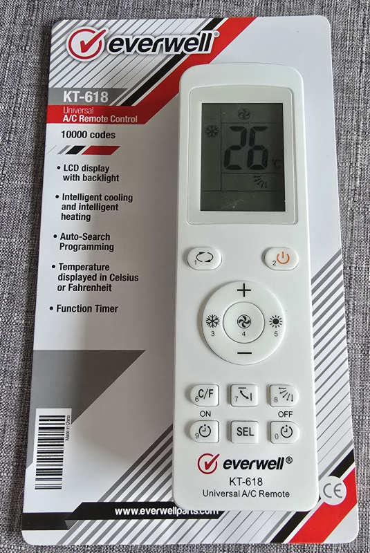

I found that the Everwell KT-618 universal AC remote controls the Air8 using remote code 5080. There are cheeper universal remotes that cover code 5080 but the 618 has a backlit display and a wall mount.

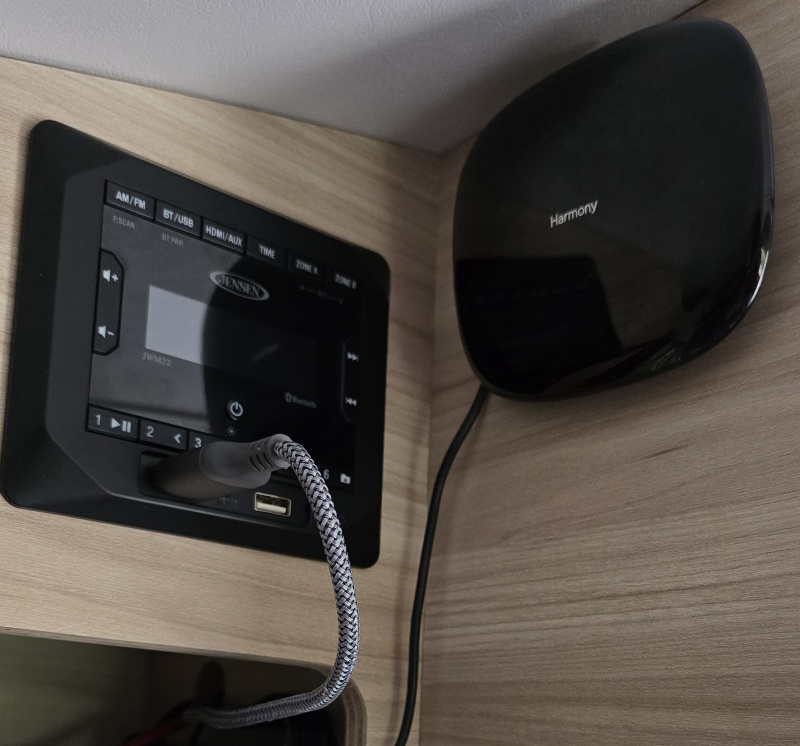

Although an IR remote for the Air8 seems silly in such a small camper, I was motivated to get one working in order to train a Harmony Universal IR remote for internet based remote control.
The Harmony remote enables both voice, via Google Home, and internet control of at least the on/off function for the Air8.
The Alde "EXT" control is great on a cold day to remotely turn on the heat in advance of arriving back at camp. I use relay 2 on the Victron Cerbo-GX to turn the Alde on and off remotly.
With remote IR control of the Air8 we can now enjoy simular AC functionality on hot days.
