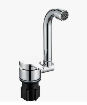

So it seems like the model above isn't available online anymore. Anyone tried other foldable models and willing to share what's working in their Tabs (ideally along with photos if possible)? I'm having some analysis paralysis. I liked the long neck version with single centre handle like the posts above but it's not available - the closest is the 1st image below but the neck is a lot shorter so not sure it'll work as nicely in our sink.

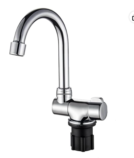

Meanwhile, the second image below is available and has the right neck but a different handle - I'm wondering if that's harder to control water flow since it seems like it only has a temp adjustment and no flow adjustment - anyone have any advice/experience?
