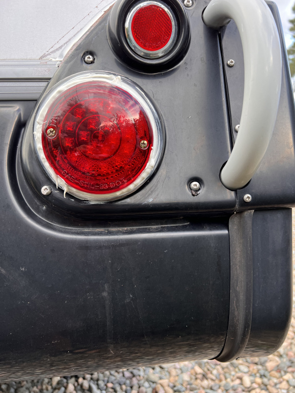

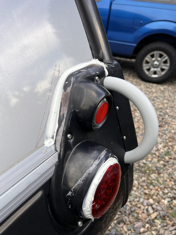

Hi I know this may be an old issue but it my current issue. Arizona monsoons well they’re monsoons and I am having water issues as explained above. I have sealed it with 3M marine adhesive sealant fast cure 4200.Do I need to seal the entire area? I’m learning as I go.
@HowlinWIndWalkr Rather then remove all the light I did the same thing 2 years ago and so far no leak! Art2019 TaB 320 S Boondock Edge0
