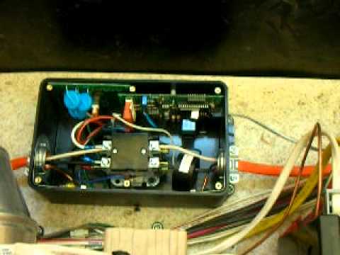

I have this exact model installed in my T@b Max cs-s. I have to find out why it keeps reading that I have crossed polarity. I've checked everything I can think of with my voltage meter. When the protector is on everything works except for the outlets. When it's off - everything works, including the outlets. Any ideas or suggestions? My brother is a licensed electrician so I'll have him come and look at it also but wondered if anyone has had similar issues.cam42 said:gg144 check this video out.

Crossed polarity would indicate that the hot and neutral are reversed. With your meter, measure the black wire with the other probe touching the ground wire. If it reads zero or close to zero, check the white wire. If it reads 110 VAC, then the hot and neutral are reversed for sure. If this is the case, then it could be that the outlet on the side of the T@B, where you connect the shore cord, is mis-wired. This also assumes that the outlet you are connecting the shore cord to is wired correctly.
In terms of why some things work and others not, I am assuming you are indicating that the fan, TV, entertainment system and lights work at all times. This would be due to the fact that they are DC and would run off the battery when there is no AC connected to the T@B.
One other thought is for you to ensure that the black (hot) wires are connected to the correct terminals in your surge protector. The terminals should be marked or denoted by the color of the screw. The standard is brass for hot (black wire) and silver for neutral (white wire) and green for ground (bare copper wire). Also make sure that your input and load side are the correct way around. I am not sure how it would react to the input on the load side and the load on the input side, but I am guessing it would indicate some type of fault.Martin - Trailer name: James T@Berius Kirk1 -
Thank you Martin! The wires inside the surge protector are installed correctly according to the schematic but I will test them to make sure. I have it connected to a shore line that runs to my house (which is also surge protected). I'll keep checking the wires that I can access. I really appreciate your expertise. I had forgotten about the AC/DC differences. That makes complete sense. Thanks again!

I found the problem Martin. You were right about the shore cord being in an outlet that was improperly wired. I fixed the wiring and now have a clean reading. Thanks again for your insight.mawebb said:Crossed polarity would indicate that the hot and neutral are reversed. With your meter, measure the black wire with the other probe touching the ground wire. If it reads zero or close to zero, check the white wire. If it reads 110 VAC, then the hot and neutral are reversed for sure. If this is the case, then it could be that the outlet on the side of the T@B, where you connect the shore cord, is mis-wired. This also assumes that the outlet you are connecting the shore cord to is wired correctly.
