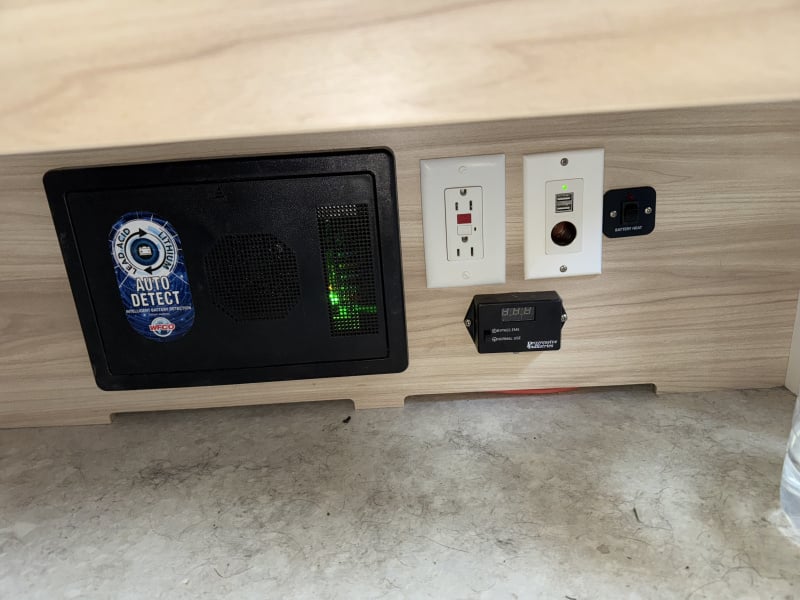

HappyCamper2024 said:I know what a GFCI is in my house, but it's per plug. Is there a central one in the camper or do you mean the one at the plug for the appliance we are using? Is there one for the Aire8?My 2024 320S BBC has a GFCI by the rear bench.My Victron inverter also has a GFCI, but is moot for shore power.Don Montalvo | Retired Veteran | Full time boondocker

Sorry not "side bench", but by the WFCO:HappyCamper2024 said:Thanks for the GFCI info, I'm going to check that out todayDon Montalvo | Retired Veteran | Full time boondocker

“Great idea on the extension cord. We have two USB powered fans for sleeping or use at camp, plus a plug in "air mover" that probably uses a fair amount of power so we'll see if that's an option. We would only use that outside though, do you advise against plugging that into the tab outlets outside if the AC is on? Your TaB has a 30 Amp limit. If your power draw exceeds that, a breaker will trip. You have 5 AC circuits that should be labeled like this photo.
The 120 V outlets are protected by 1 GFCI on Branch 1. The Alde, A/C and MW are on their own circuits without GFCIs. If you plug something into the outlets on circuit branch 1 that has stray current or excess current it will trip. The whole point of this is to appreciate the electrical limits of the TaB. I am not sure the draw of the Air8, but probably running the MW, a hair dryer, and the A/C at one time may not work. That is why I suggested using the 120 V outlet at the pedestal to plug in something that may exceed the TaBs limits.

My label isn't so helpful, attached. It sounds like I shouldn't use anything but the AC, not even a fan, unless it's plugged into a pedestal. That's all I was gonna run but it sounds dicey. But just in case I will try to get some fuses. I can't see any visible fuses. Gonna look for a fuse yt now but if anyone has a suggestion...
@HappyCamper2024 - you need to open the front of the Power Center by pushing in the top of the plastic box that is on the front of the driver side bench. Look at the AC breakers on the left side.
MW is microwave.
